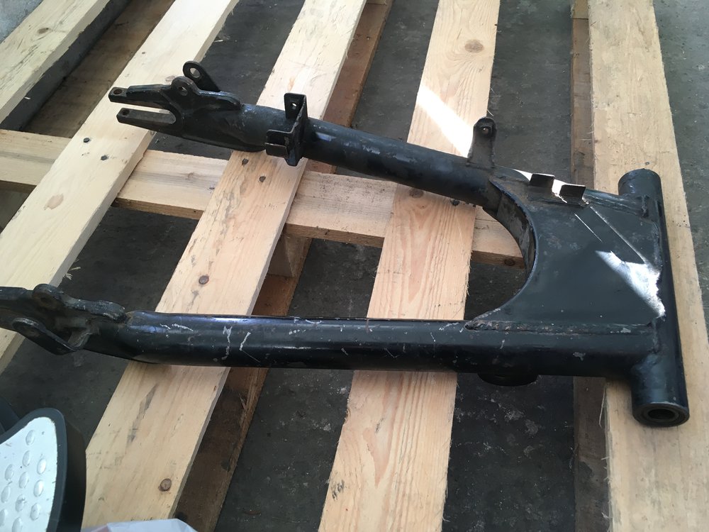

When I collected the bike I was given a swinging arm as the bike had a box section arm fitted.
Have noticed today that there is no grease niple or date stamp ?
Is this off something else or could it still be the original :?? ??
Thanks for any help as I would like to sort before painting.

Not really much help but 650's stopped having a grease nipple in about 81, if using the same thinking, all 900's should have them as the latest would be 76 poss reg'd in 77? Z1, Z1A, Z1B & A4's show them as having them in the parts catalogue.

Should have a grease nipple.

if you remove the sleeve you should be able to see if it ever had a grease nipple as you will see the threaded hole. it looks like it has been welded over ?

Just had a quick look.
The swinging arm has a needle bearing each side with a sleeve that is held between the two bearings.
There is then an inner sleeve that runs the full width of the swinging arm inside the bearings.
So I guess in this guise the grease could not go anywhere even if there was a grease nipple ? :??
The arm is packed with grease between the inner and outer sleeve.

kawasaki didn't fit needle rollers until the z1000a1 but yours is not from that model

Just spent a couple of hours in my garage fitting the swinging arm.
Removed the box section one and fitted the swinging arm that I got with the bike, all went well..
Suddenly OMG :x :( :cry:
The wheel axle does not fit into the swinging arm slots :!: :!: :lol:
Well you have too :lol:
Axle 20mm, slots 17mm
Thank you all for your help, I will order a replacement from the US immediately :D
