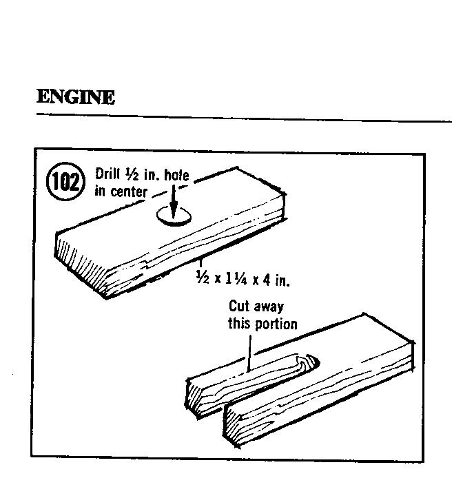

I also use a tool to hold the pistons flat
I'll did out a diagram of it in a bit but it's basically a piece of mdf with a cutout for the Conrod

I think the blocks to hold the pistons level are ;
viewtopic.php?f=4&t=35063&hilit=compressor
Posts: 4586
Re: Drain Pipe !
#8 PostAuthor: chrisu » Sat May 20, 2017 11:04 am
piston support.jpg (53.46 KiB) Viewed 7299 times

#10 PostAuthor: 1975-S1C » Sat May 20, 2017 9:29 pm
Aha, now I see how it's done.
I've purchased some drain pipe today so I'll make some collars tomorrow and a couple of those little wooden fellows too.

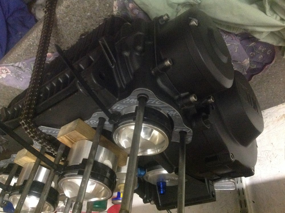

So I made some of those piston ring clips out of drain pipe and bought cable ties, tonight I made the wooden pieces to hold the pistons still. So far so good.
I then go to try the little blocks of wood in place, turn the engine slowly to raise the middle two pistons and then the bloody cam chain snarls and lifts the guide dislodging the little rubber blocks, one of which I can't find. I assume it's either gone down the cam chain tunnel or down one of the inner 2 piston holes in the crank case. The air turned blue at this point.
Question is, where do I go from here ? Is it likely to do any harm ? Might it come out if I drain the oil ? Or am I screwed and have to strip the whole flaming thing down ?
