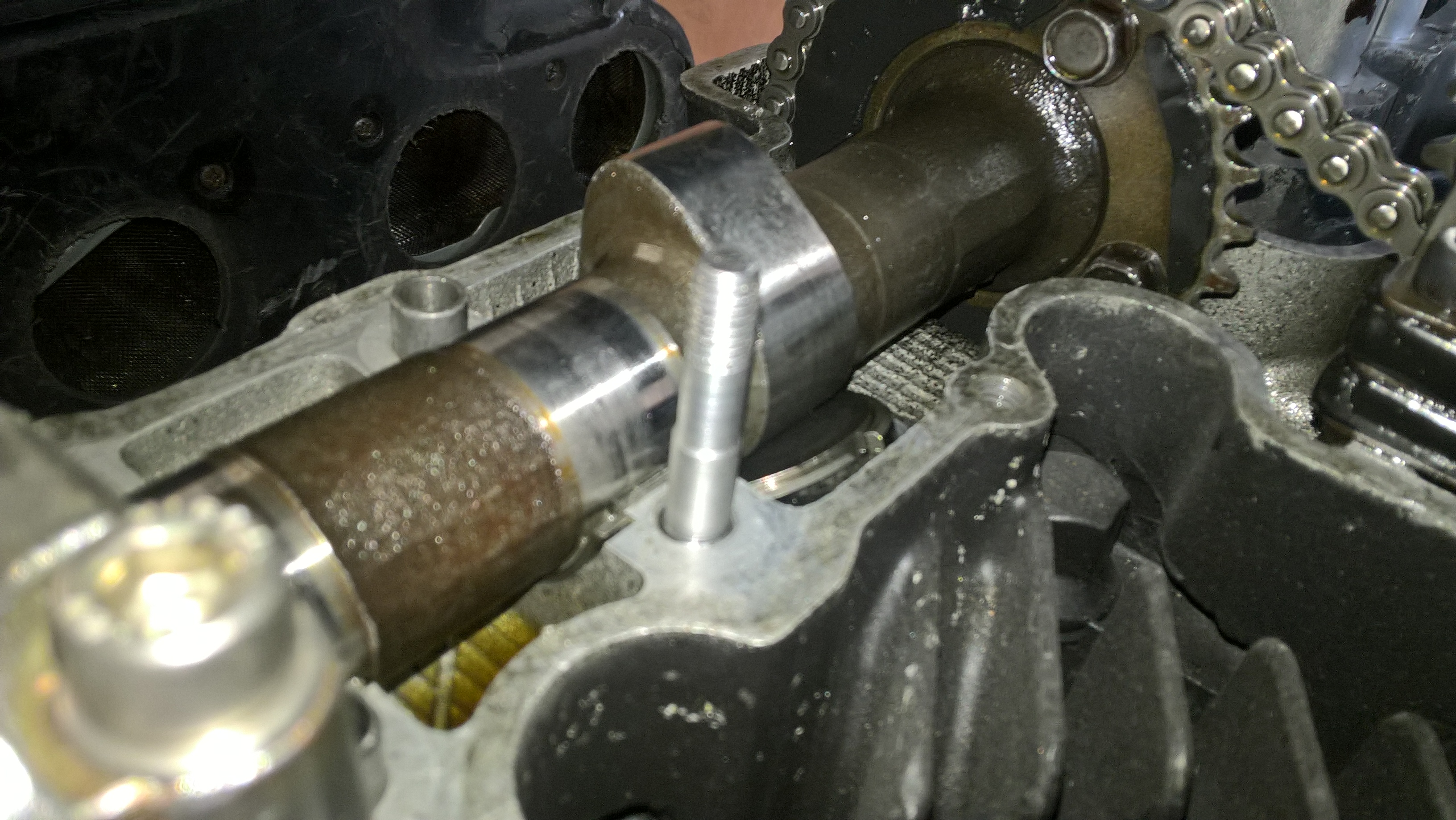

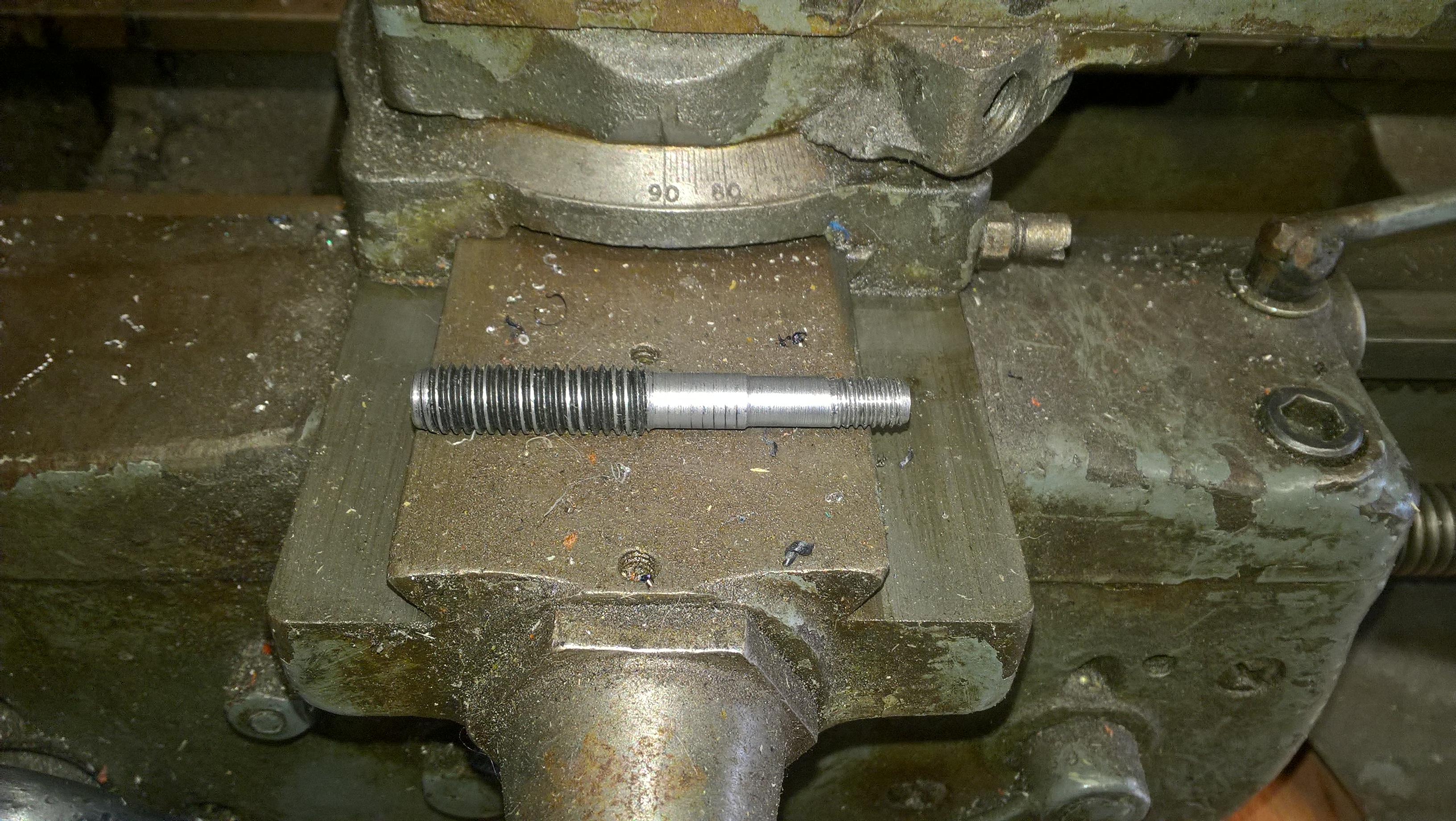

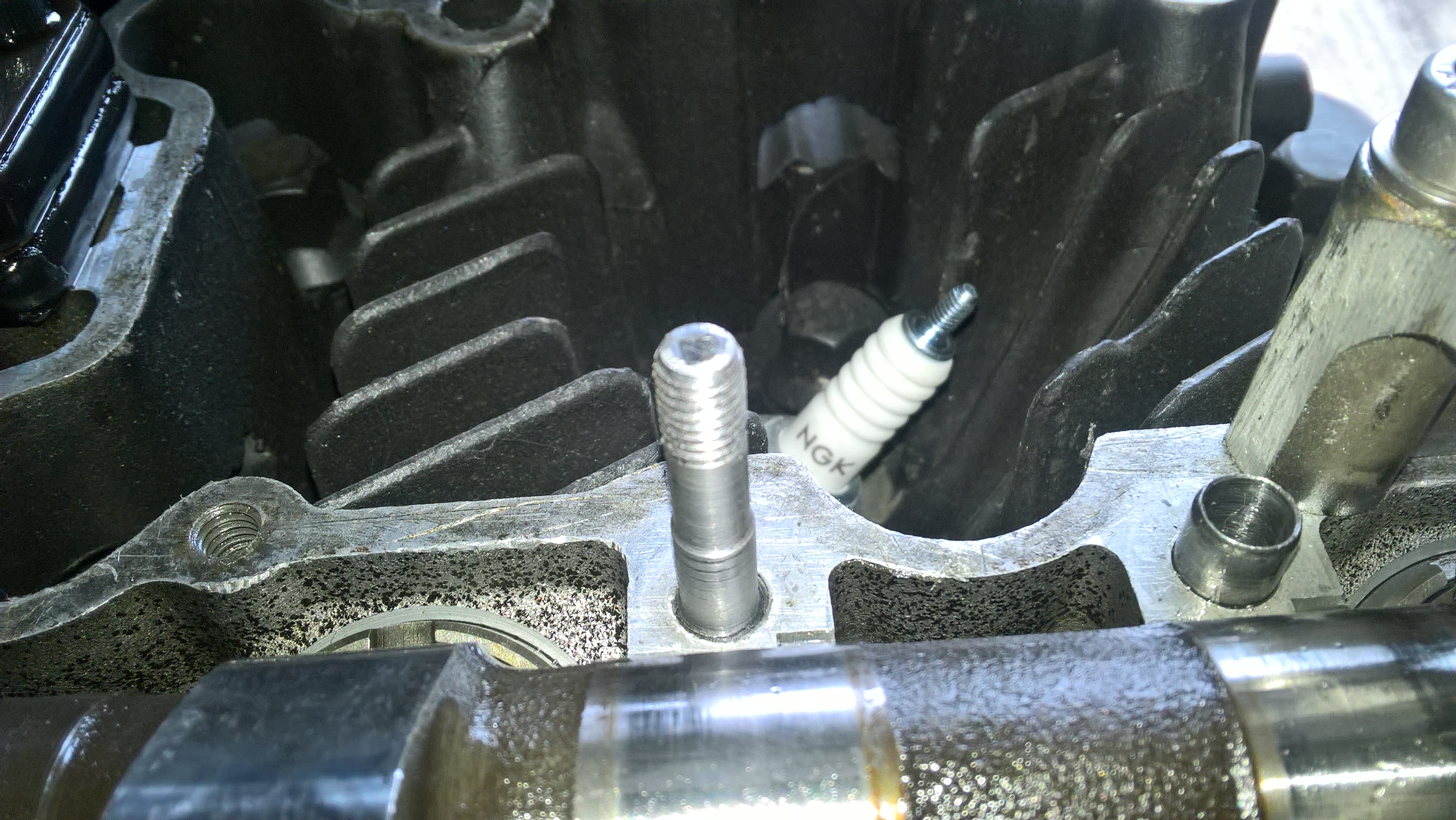

Repaired one of mine this week with my stud design, all done while still on the engine, slow process but completed today.
