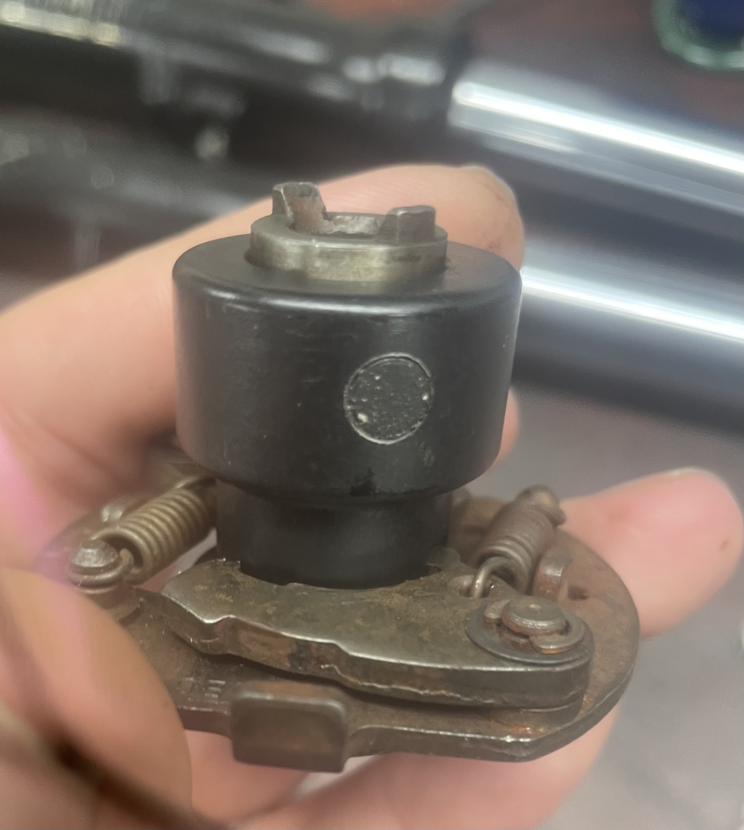

Hi Warren I went for the Chinese option! Finally got myself an advancer so that’s this weekends job. I had. A Quick Look and noticed the replacement sleeve with the magnet is a good bit shorter than the original mechanical part. Did you notice this at all? I’m assuming I just space out the slack with something to the top of the advancer bolt but wanted to check incase I’m missing something. Cheers Lee

warren3200gt wrote:I've never had to add a spacer that I recall on any 650 ones I've done.
Sure you've got the right advancer?
Hmm that’s a good question warren. This is I belive Z750E advancer (1013) marking. But it is a z750E engine so that’s what I went with. I would have thought the lengths would be the same but maybe that’s the problem..

#11 PostAuthor: LeeJackson » Sat Oct 18, 2025 5:28 pm
See pic Warren looks like it lines up ok with the plate for the magnets but definatly too much play?!

#12 PostAuthor: warren3200gt » Sat Oct 18, 2025 6:23 pm
What's the part number on the advancer?
21148-011 is the 650 b1 - b3 one.
It looks like 650 / 750 advancer are different.
I don't have a parts list for a 750 to cross reference. Just looked it up on cmsnl
21148-1013 is the number for the 750 E.
Either way, where there's a will there's a way. Just gotta figure it out

#13 PostAuthor: zed1015 » Sat Oct 18, 2025 8:11 pm
LeeJackson wrote: See pic. looks like it lines up ok with the plate for the magnets but definitely too much play?!
If it lines up with the pick ups you just need to loosely shim up the gap between the end of the rotor and the 17mm nut.
However i would check the security of that magnet as some are known to work loose and wreck the pick ups .
Most of these pattern ones have the hole drilled right through so it may poke out from the back and then set it back in with some araldite.

#14 PostAuthor: LeeJackson » Sat Oct 18, 2025 8:21 pm
Thanks that’s great advice! I did t fit it today as went a bit ott last night so will get on it in the morning and check that first! Thanks

#15 PostAuthor: LeeJackson » Sun Oct 19, 2025 3:35 pm
Well it’s alive and kicking. Chinese Dyna working fine so far! Cheers Lads.
