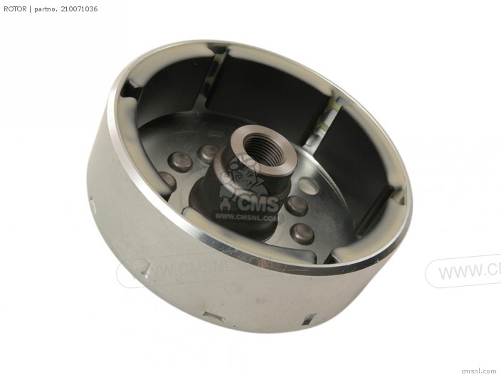

Hi all.
In need of a decent rotor with the magnets intact please for the J based engine (looks like this and think th part number is 210071036 ).
Anyone help. :roll:
Thanks in advance, Will.

#2 PostAuthor: z1bman » Sat Jun 04, 2022 8:49 pm
according to electrex world the rotors they sell for the z1000j also fits the kawasaki er5 the only difference is the metal strip wich triggers the pulsing coils on the the er5 there are plenty of er5 rotors on ebay & the magnets are encased in a metal cage its worth a shot at purchasing one from a er5 & grind away the steel strip from the outside of the rotor if necessary note the rotor must be stamped GP9331 like this one
https://www.ebay.co.uk/itm/232742205572 ... 6UeOfsM%3D
https://www.electrexworld.co.uk/acatalo ... ml#SID=659
