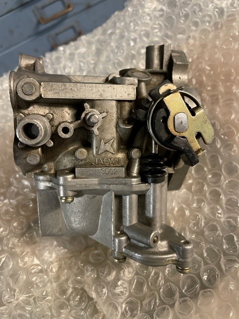

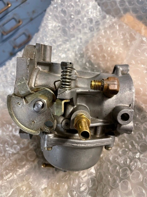

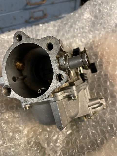

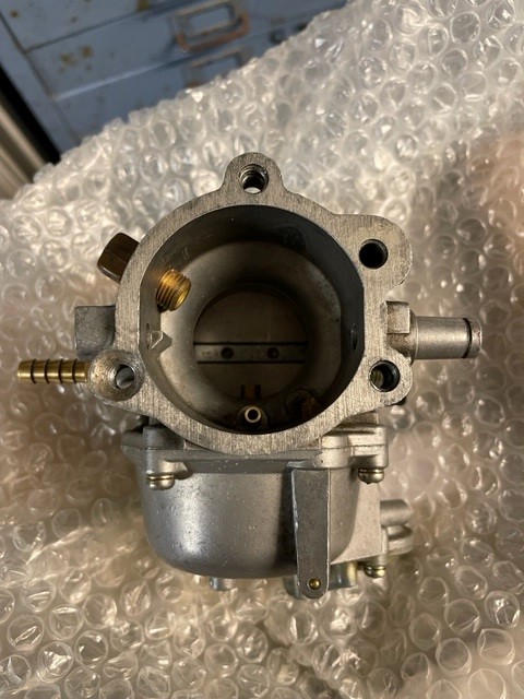

I found this in a box at the back of the garage, seem to remember it coming off a turbo bike, looks like some sort of elbow for Thunder Jet type addition, doesn't look like a NOS fogger port. Looks to be all complet
paid up member
Posts: 4036
Re: Z1R Turbo Carburettor
#5 PostAuthor: zed1015 » Thu Jan 06, 2022 10:02 am
That's a 42mm Keihin carb off a Mr Turbo kit.
Had a couple of those, one of which had the same brass elbow which was more likely to be the remains of a water injection set up as it bore no resemblance to a thunderjet or nitrous part.
