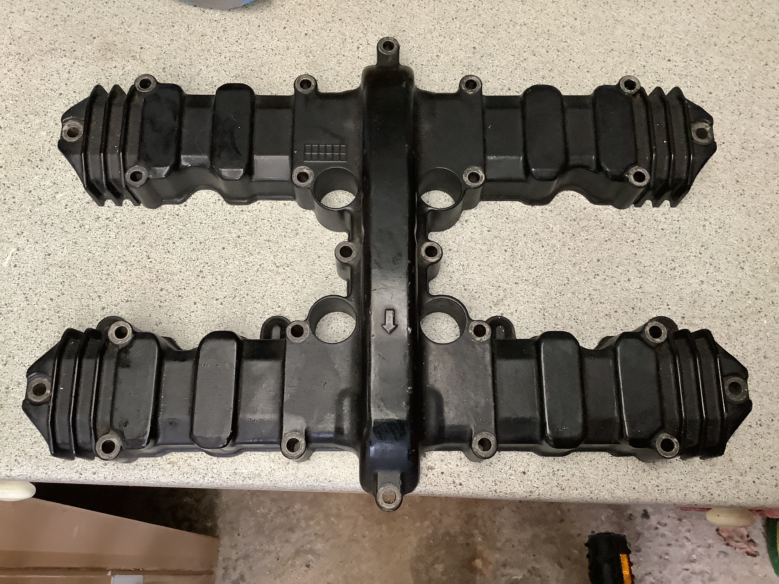

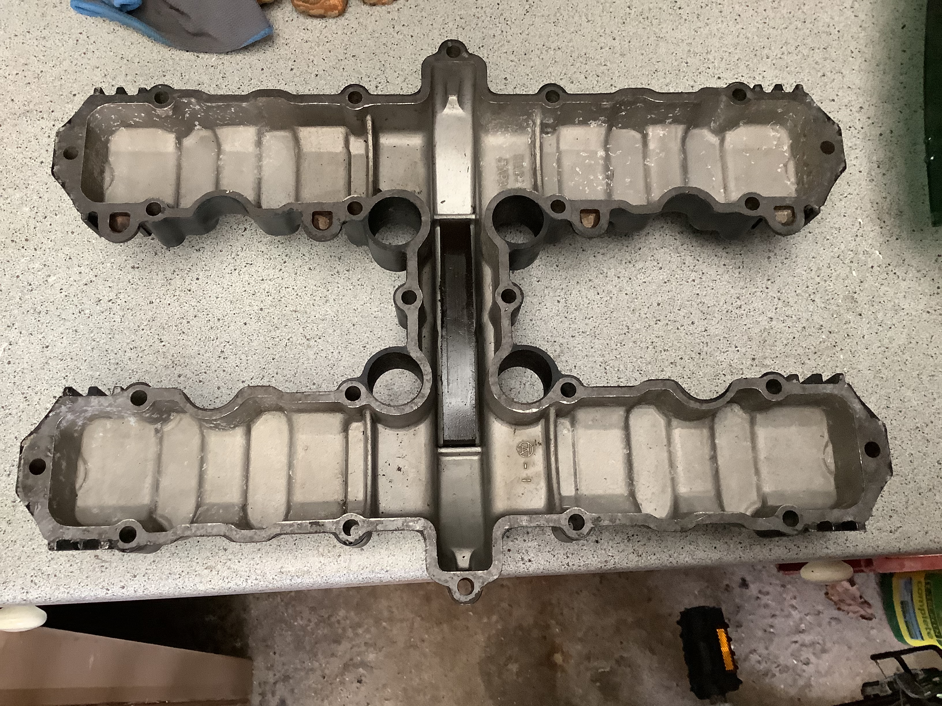

#8 PostAuthor: Coose » Thu Feb 04, 2021 6:43 pm
Scott,
In this photo you can see the joyous hacksawing fun I had one sunny afternoon. Hopefully this should give an idea of what to chop and what you need to keep. :)
The main thing is to keep enough coverage across the top to correctly locate the top guide, and keep the six bolt holes.

#9 PostAuthor: scott » Thu Feb 04, 2021 8:08 pm
Thanks Ian, gratefully appreciated. The pictures will help my wife a lot, she has a steady hand :lol:
