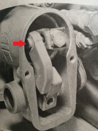

So I whipped off the carbs to fit my newly acquired airbox and noticed that one of the slides wasn't moving smoothly. Popped the top cover off and discovered that the little peg on the side of the lever that connects it to the slide connector has come adrift from the lever and the slide connector was moving sideways far more than it should be.
Don't suppose anyone has a spare lever or perhaps a complete slide/connector/lever assembly?
Couldn't get a picture so have attached one from a well known book so I could point out the bit that's come loose.

Exactly this, thanks. Was hoping to find one in the uk, but this will do :)
