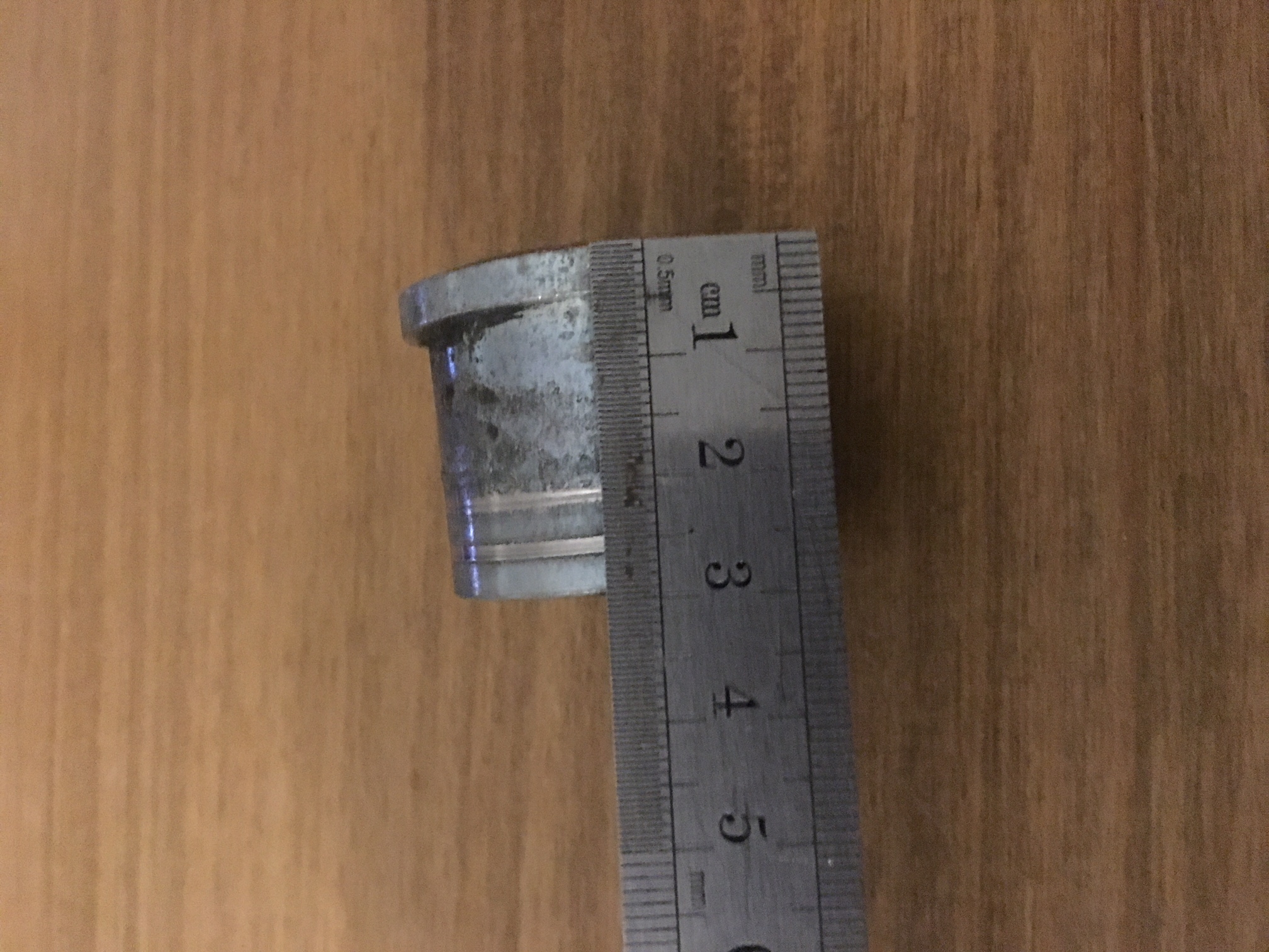

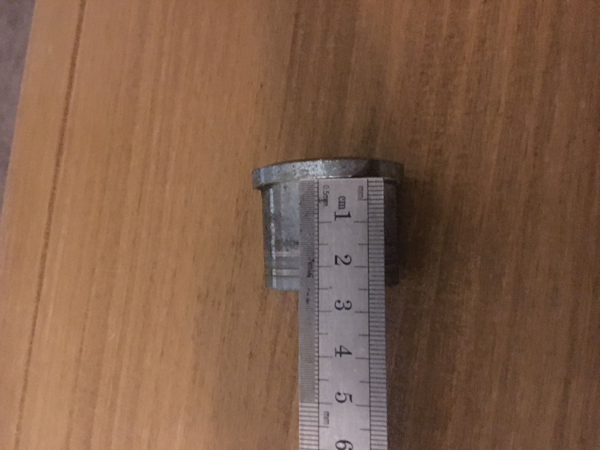

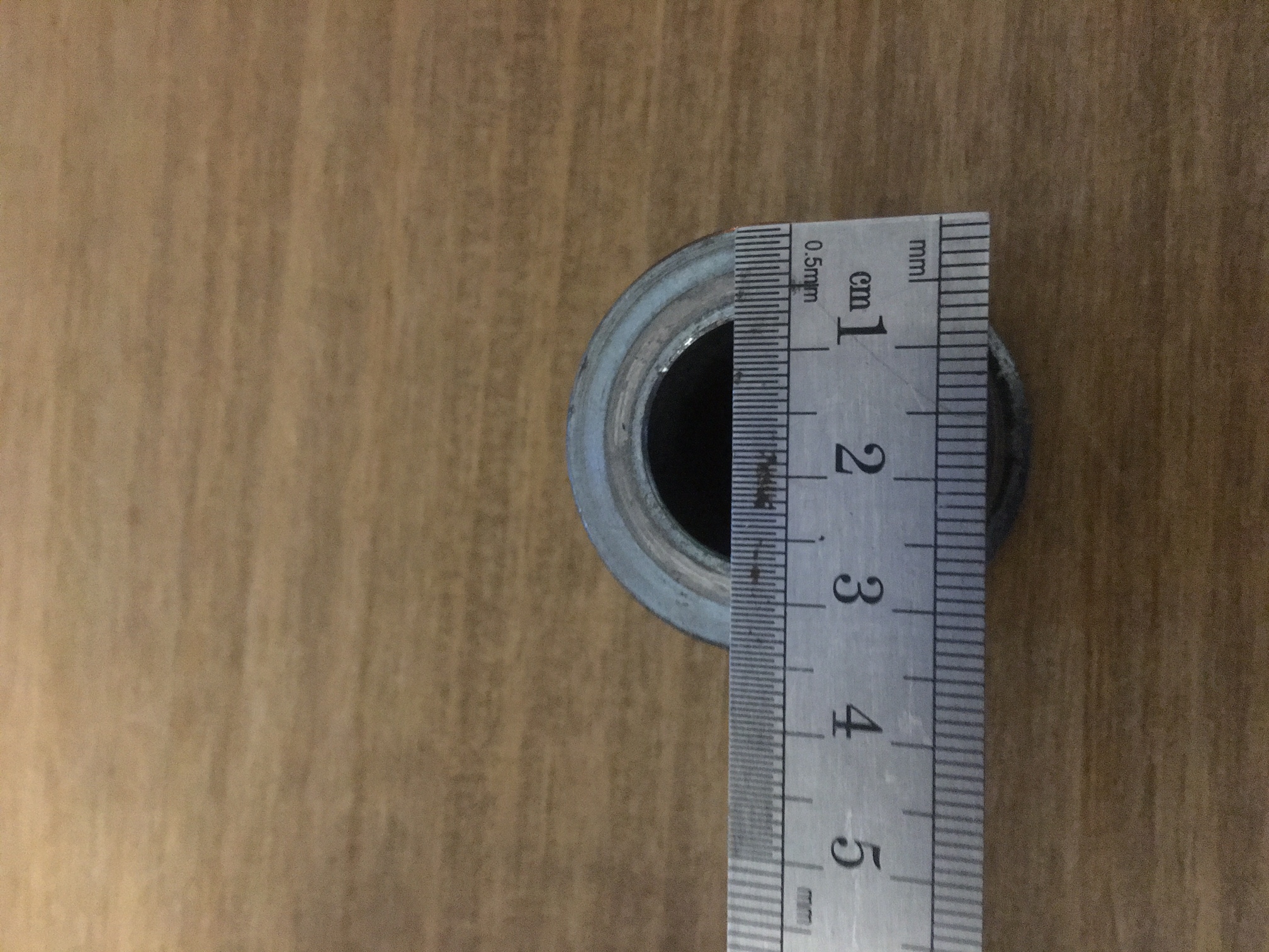

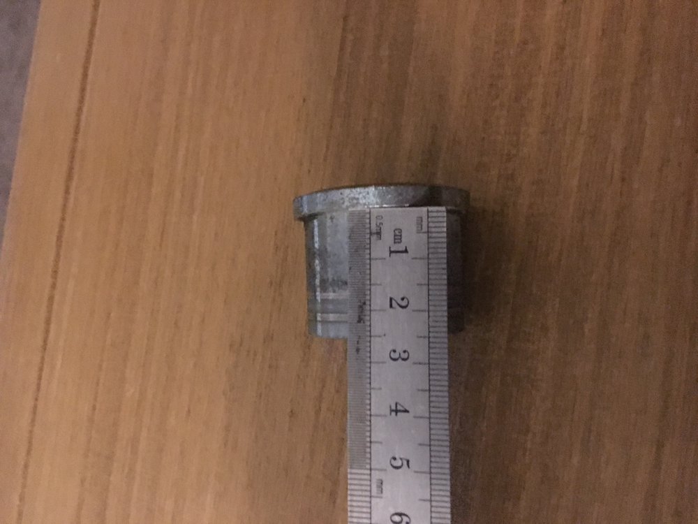

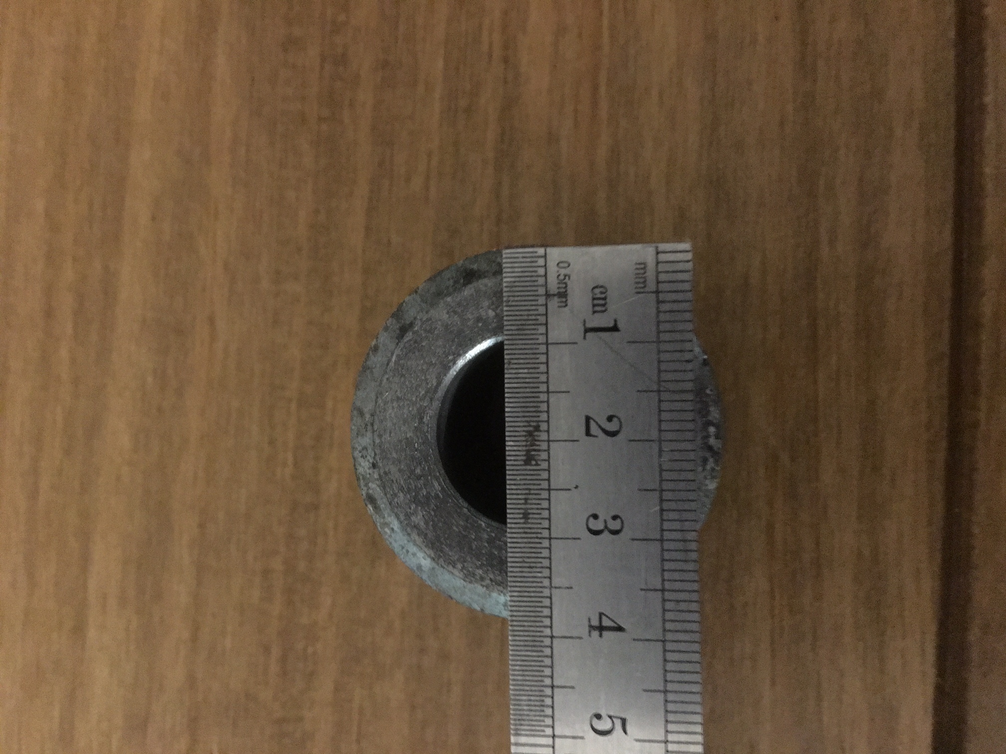

#4 PostAuthor: compo z1r » Tue Nov 07, 2017 8:07 pm
KeithZ1R wrote:Its as "top hat " collar, will have a measure up, dont think I have a spare so the wheel will have to come off, lucky for you I have new chain and sprockets to fit :)
if you want it on the Vern's ill do it tomorrow

#7 PostAuthor: KeithZ1R » Wed Nov 08, 2017 4:26 pm
Now this is intertesting because the spacer I have is the same as Neils except its 6mm longer and sits inside the 35mm seal in the hub.
The distance from the front face of the seal to the inside edge of the caliper carrier is 30mm. I have measured mine and this distance is constant on em all to allow the disc to sit in the middle of the caliper and the spacer to sit inside the seal lip by 6mm which would point to em all being that length.
This means that for the shorter spacer to work you would have to put it in with the wide face sitting against the front face of the seal which doesnt make sense, I'm confused :?? ....not helped much have we :roll:
