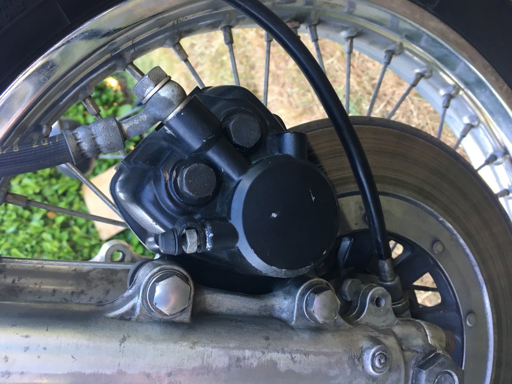

Hi all,
Does anyone have a right hand brake caliper and bracket to match the attached Z1000A2 that they would be willing to sell?
postage to Cambridgeshire, bleed would be at the top and bolted behind fork leg,
BTW, What size are the pistons?
Any help appreciated
Stuart

I've got several 650/900/1000 calipers in various states. I think the 1000 has 44mm pistons and the 650 has 38mm. I'll have look and see if I have what your after.

I've 2 right hand behind leg 38mm piston but no 43mm.

Ok thanks anyway, I saw some 38mm ones a few weeks ago and wondered what would happen if you had 1x44 (or 43) & 1x38,

Or go 38 left and right. Don't think you'd notice much difference unless your going single to twin then it'd be an improvement over single 43.

Twin 38's will give you 42% increase in piston surface area over single 43.
650/750 and smaller would be 38's
