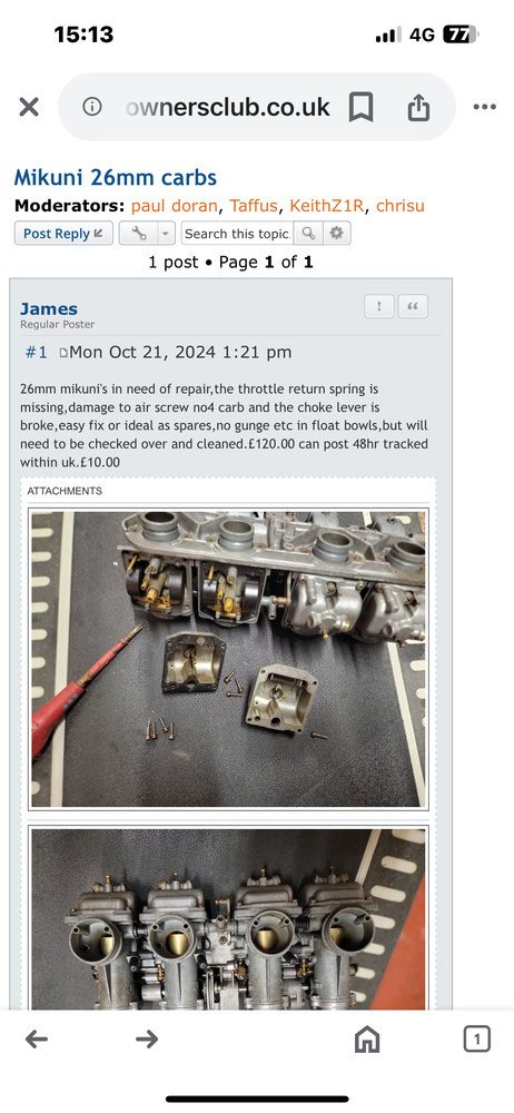

Carbs for sale in the For Sale section . :lol:

Yes, thanks Mally - I have asked about these. It doesn't say what model they are for.

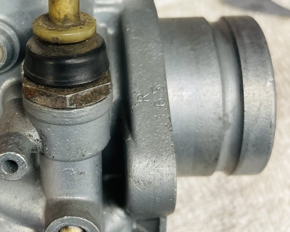

They are 26’s so will work ok , but not exactly what is on an A4 , well not on mine which are originals . :smile
Noticed they have B89 stamped on them maybe GS Suzuki carbs ?
Hopefully an expert will chip in , deffo not A4 carbs , they will be stamped R65 like mine , and also be stamped Z1 200 which is the correct carbs.

Correct!
They are Suzuki GS carbs which are identified by having both fuel and air mixture screws present.
Kawasaki VM's only have either one or the other and never both.

Yes gs carbs,very similar to the z900 a4
