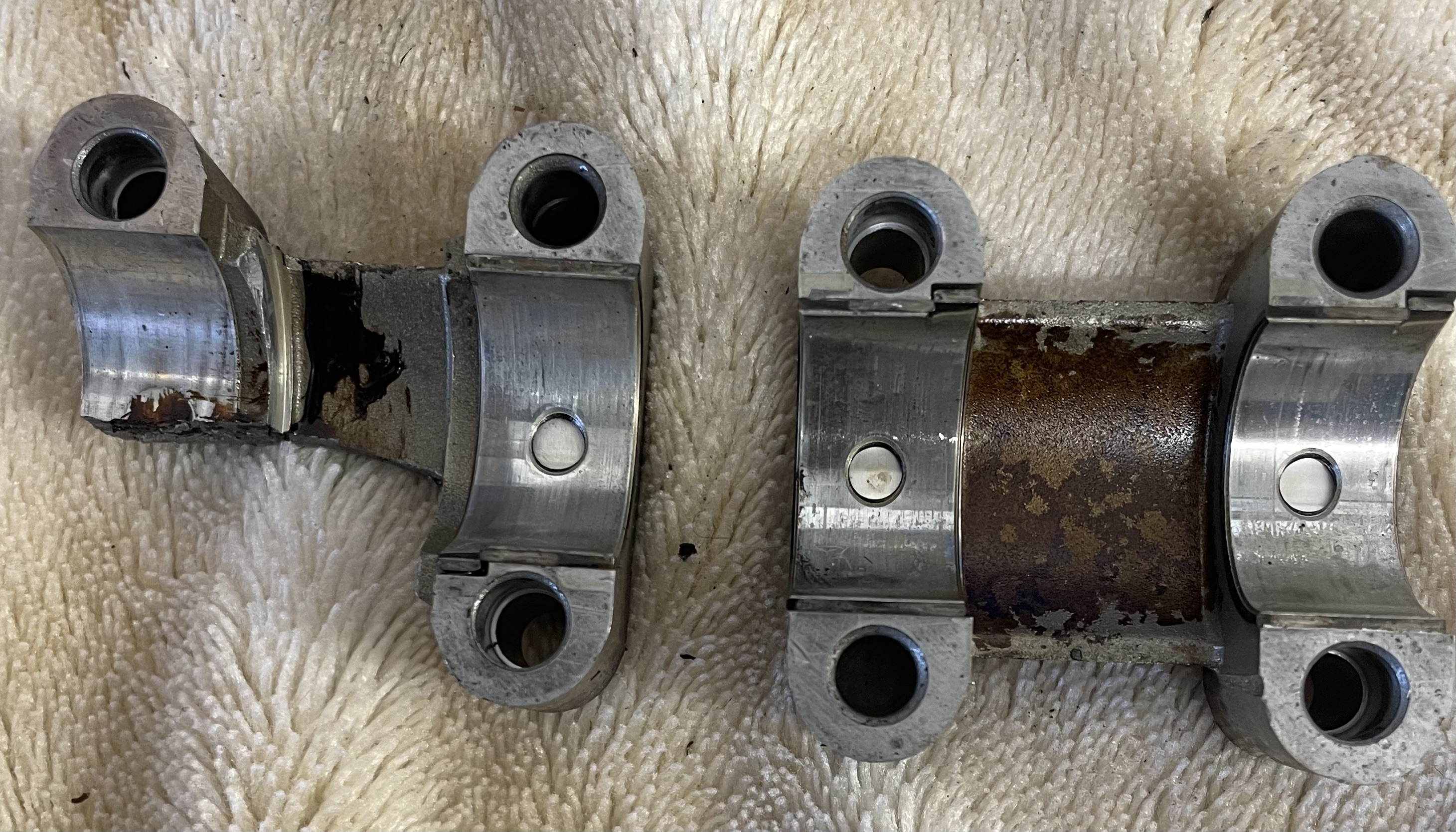

The problem is that one of the camshaft caps on my engine has broken. I been told the cap and head are a matched pair and you must not use another cap from another engine. Any ideas?

The head and caps are machined as a set but another number 1 or 3 cap which controls cam end float can be used if you know what you are doing .

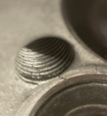

I found a cylinder head on eBay, bought it and found it had 2 cracks in the head.
Thanks for the note on the cams.

Re: GPZ1100B2 cylinder head, caps and cams
slacker wrote:Hi,
Nothing wrong with that.
Those surface expansion fissures are more common that not and won't cause a problem.
Most of these heads have them.
