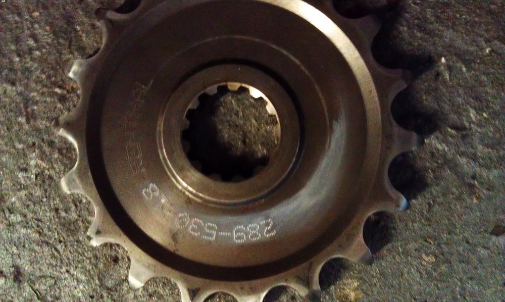

If you want to go over to 530, B&C Express should be able to supply you with a 530 rear sprocket for the Ronal wheel as I gave it to them!
As for the front sprocket the Renthal 289-530-18 fits the Z1/900/1000 motors. https://www.renthal.com/road/chainwheel ... fcw?page=3
Gearing wise for a nat asp CR, I'd go with 40th rear and 18th front.

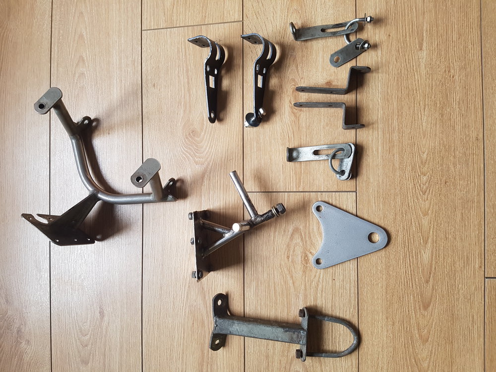

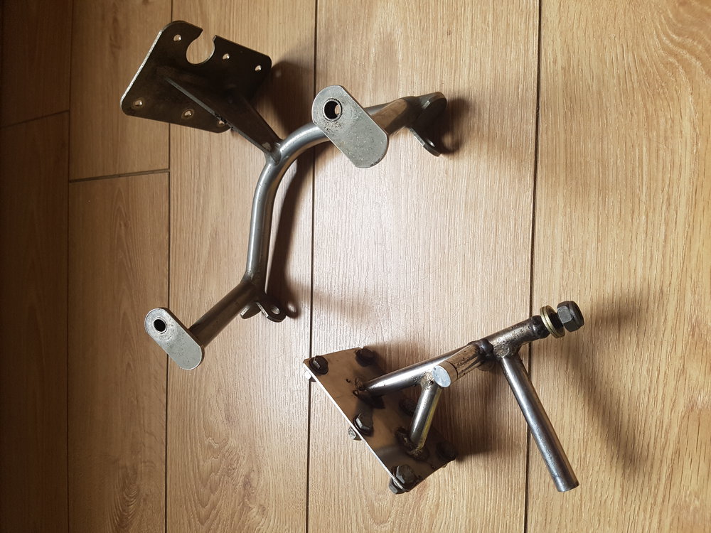

Hi,
I seem to be having trouble trying to establish how the front fairing fastens to the frame etc and have taken pictures of the brackets that i have currently.
I am to fit the dual seat with the shorter tank cover and also wondered how this fits onto the frame. I unfortunately cannot find anything to guide me so any help is greatly appreciated.
If there is anything i require further re fitment (which i do not have) then i am willing to purchase these items if anybody has them!!
Thank-you as always
Gary.

Only the large bracket you show on the left is of any use for the correct fitment of the CR fairing, the rest are of no use at all for the CR.

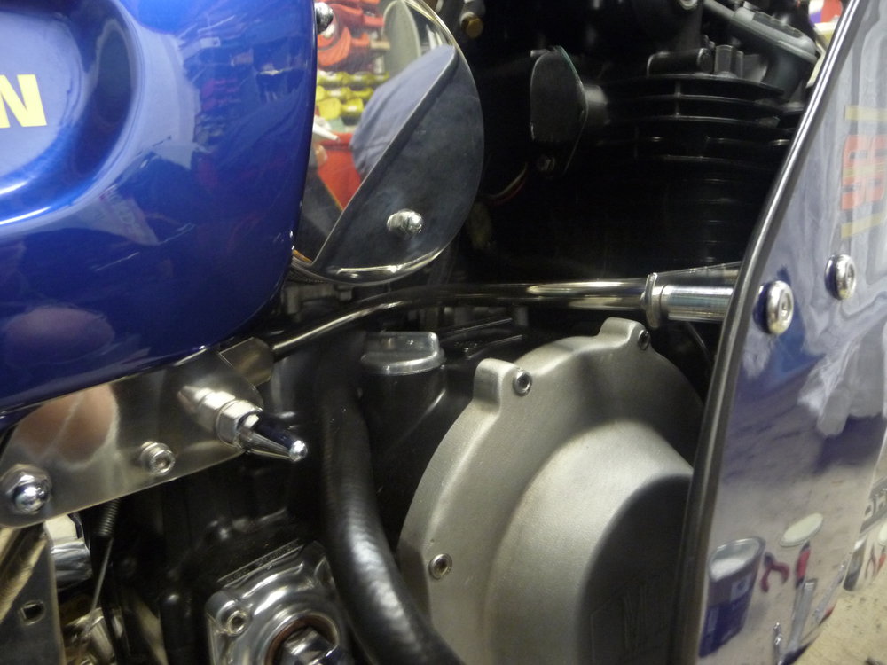

The large bracket bolts to the headstock with 6 fixings as shown on my old S+S Rickman turbo. Two bolts then secure the top of the fairing to the fairing bracket.
You are also missing the LH and RH lower fairing brackets, again unique to the CR. These are exceedingly hard to get hold of, they bolt onto the upper rear engine mount as shown here.
Part numbers for the lower fairing brackets are R10982503 for the LH bracket and R10982504 for the RH bracket. This guy in the states may have the lower brackets. https://www.ebay.co.uk/str/Cyclesavant? ... 7675.l2563
