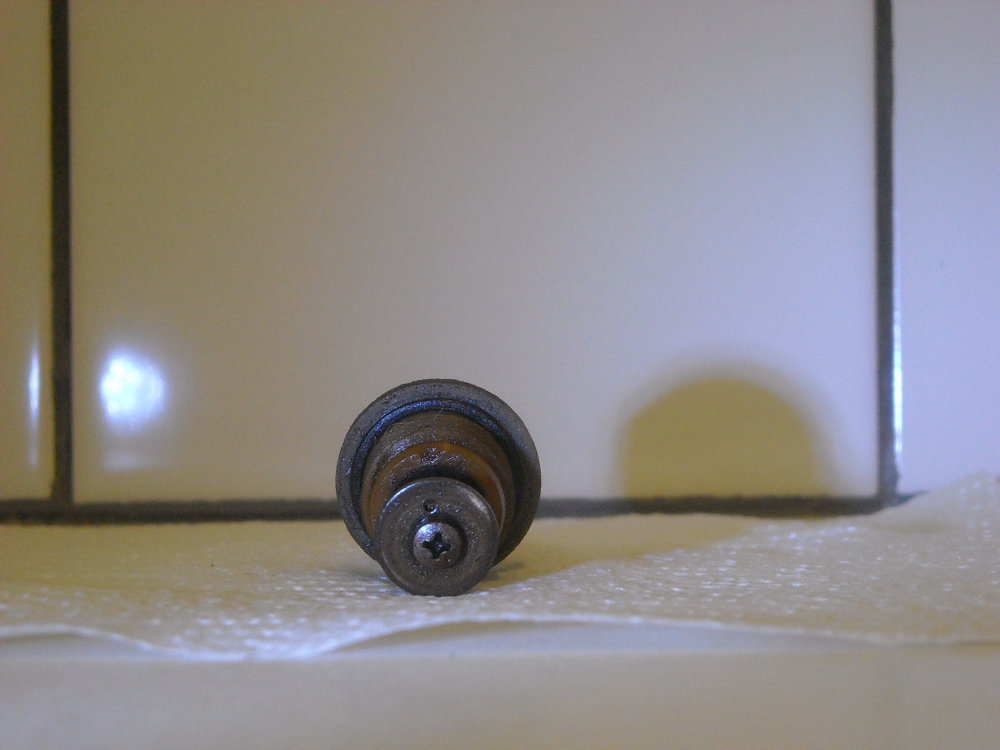

do you have an original early Z1 oil pressure switch mounted? If so, take a look to see if there's a little hole in the copper plate at the bottom of the switch. You can see the round copper plate when you turn the switch upside down. If not, drill a 1 mm hole in that plate. It was adviced by Kawasaki to the dealers back in the days to do that. The little hole allows trapped air to evacuate and the switch to make contact.
Re: Wanted- Z1 oil pressure switch
#4 PostAuthor: Philippe » Wed Feb 20, 2019 10:00 am
Hi PJONO
just a picture to make it clear.
oil pressure switch

Yep Its got a hole in it. Switch was dodgy in so much as the brass central plunger /terminal section main part was making its way out of the nylon bushing. I knocked it back in and it started working again. Be daft not to replace switch for a known good one before further investigations
