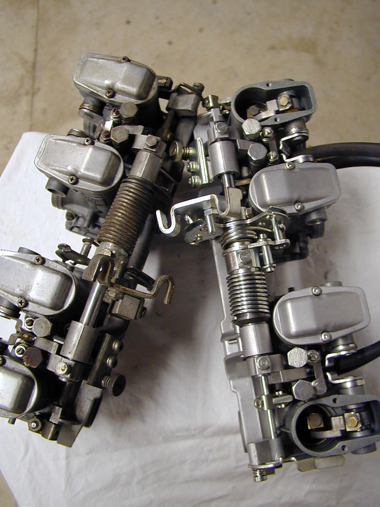

Re: Z1R Carbs
the early Z1 carbs have a lot of differences but the main one is the flat tops on the early carbs and the much higher " domed " tops on the z1000 / Z1R ....... they wouldn't look right really

Re: Z1R Carbs
Hi frankz1a
Z1A or Z1B carbs would allso do the job but they're difficult to synchronise... that's why a lot of owners changed them for Z900A4 or Z1000 carbs back in the days.
It's not that difficult to find a set of ST carbs.
Just take your time and go for a genuine set for your Z1R. After all the weather now isn't inviting for a ride and especially when you have the original cable operated front brake on your Z1R ! Mine works hardly when it's raining.
