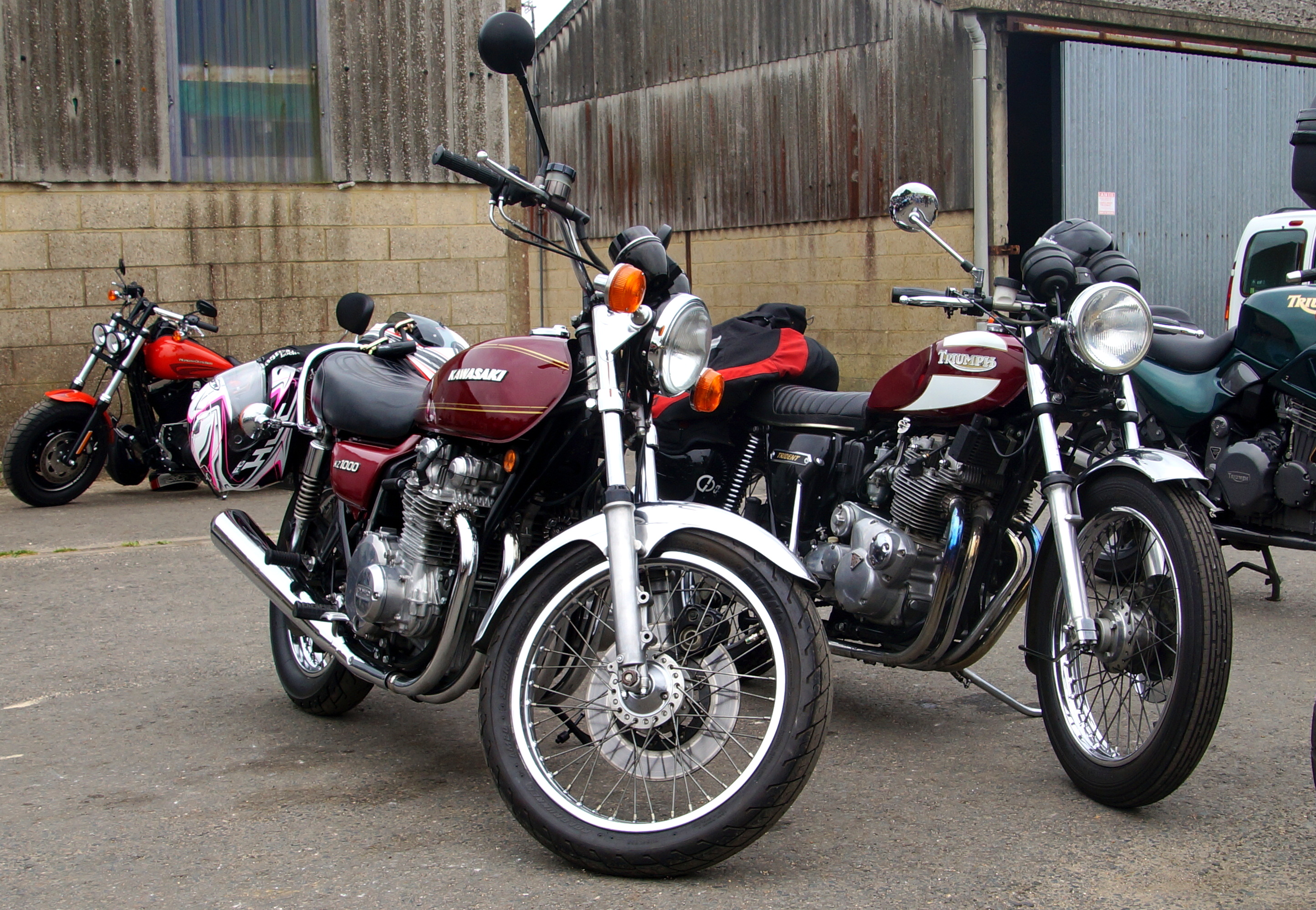

A modified Z900 and a KZ1000 at Ardingly this morning.
Re: Ardingly classic bike jumble

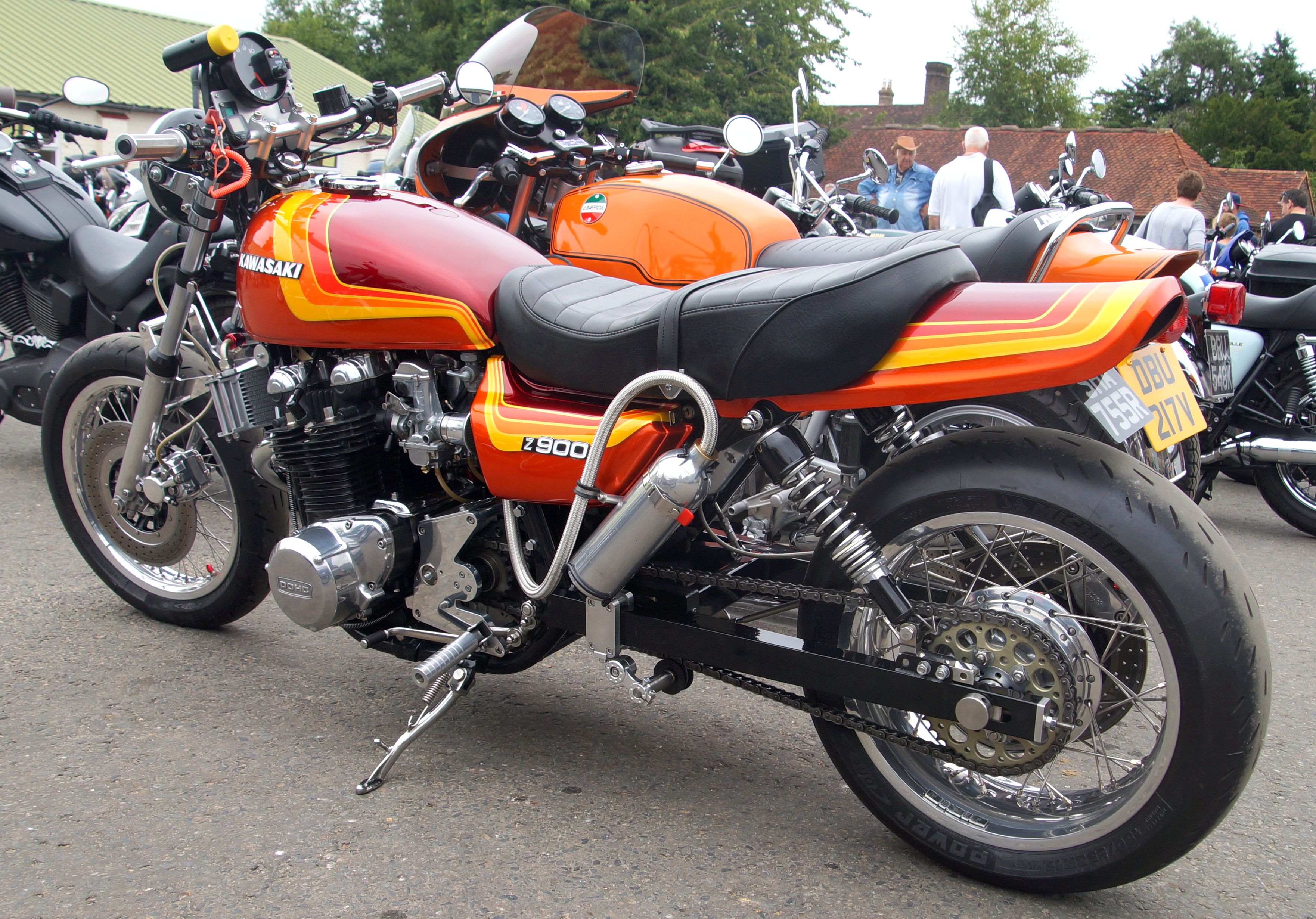

The modded 900 belongs to Paul Whitehouse. Fantastic bike!

Cheers Jay....trust all is well with you. The show was a bit quiet, especially from an exhibitor perspective, compared to previous visits.
Since that event I've re-routed the crankcase breather hose along the top frame rail, exiting under the duck tail, and into the catch tank. The loop in the hose, under the side panel, as seen here was causing a problem as fluid was building up in this area and causing a pressure build up through the casings and finding it's weakest point to exit the engine...in my case the blanking plate that covers the old tacho drive at the front of the engine. All seems ok now.
Next run out will be to the open day at 2 Wheeled Miklos on the 12th August, closely followed by the Capel Classic Car and Motorcycle show the following weekend.
