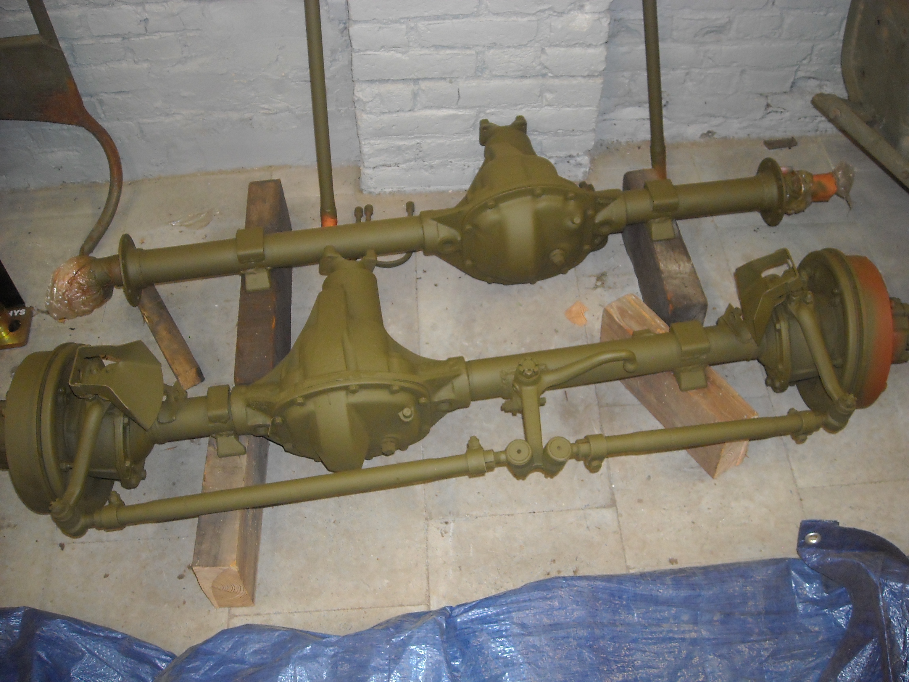

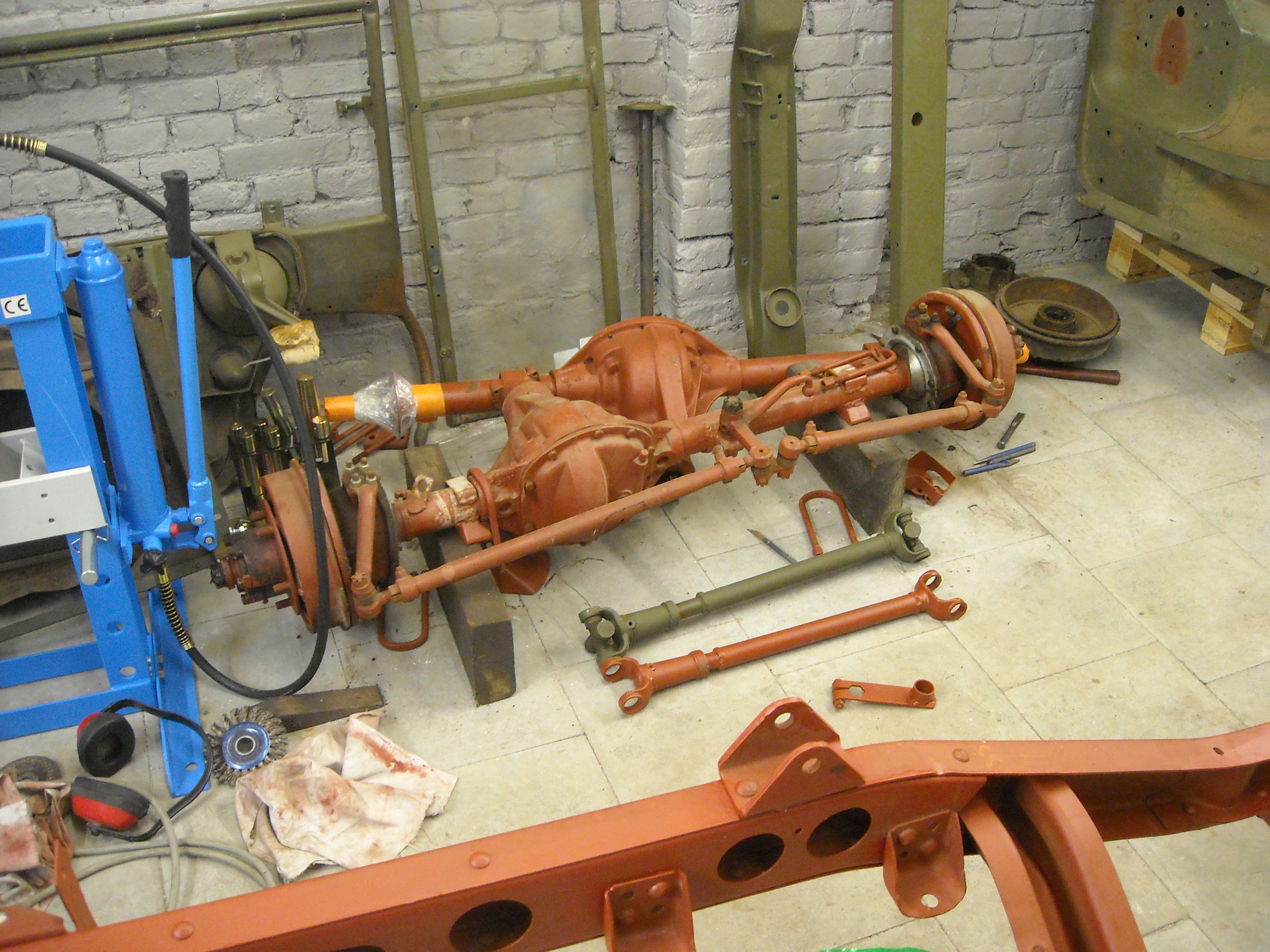

the axles
The front and rear axle, painted in red primer

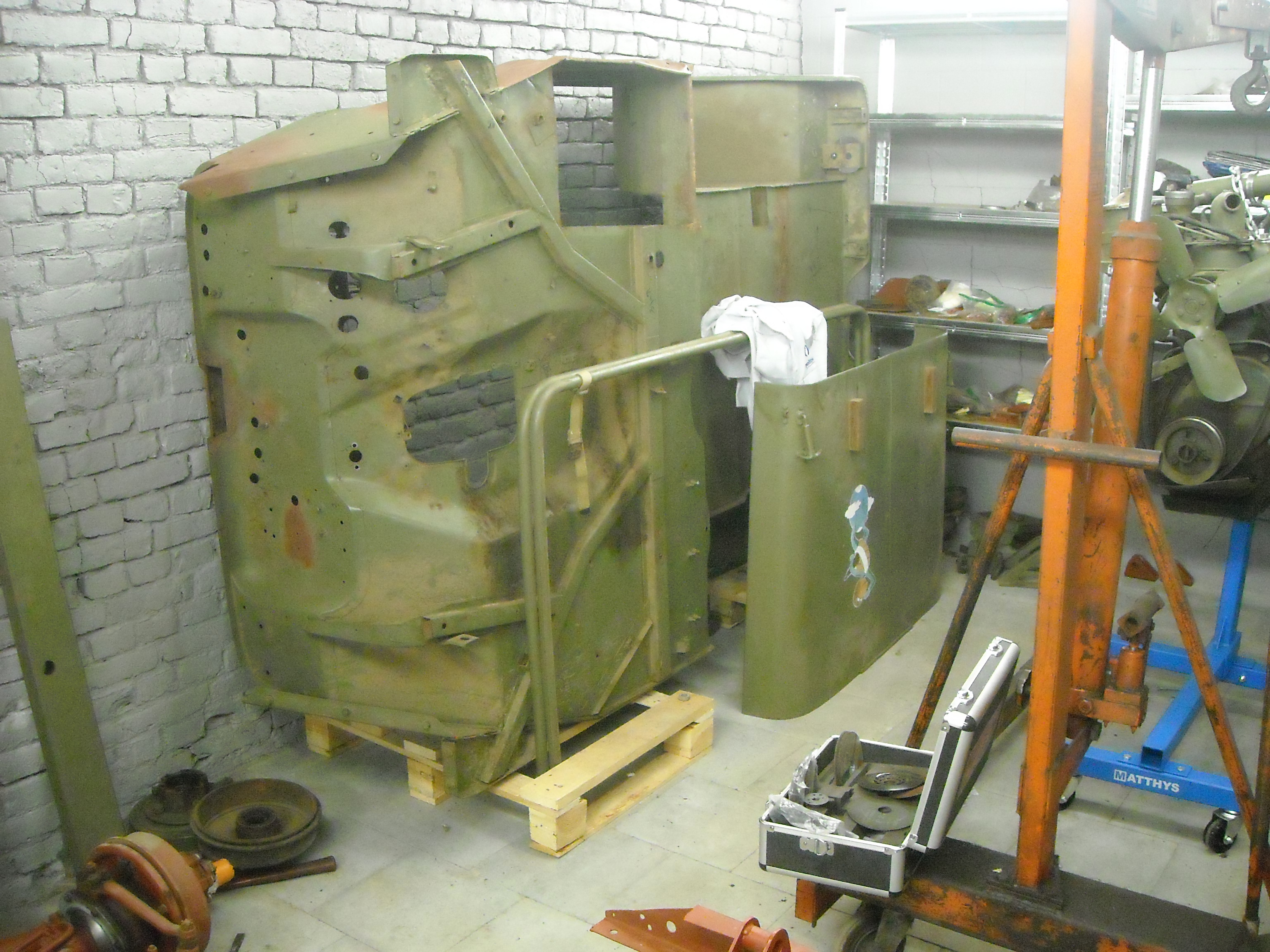

The tub and a few body parts

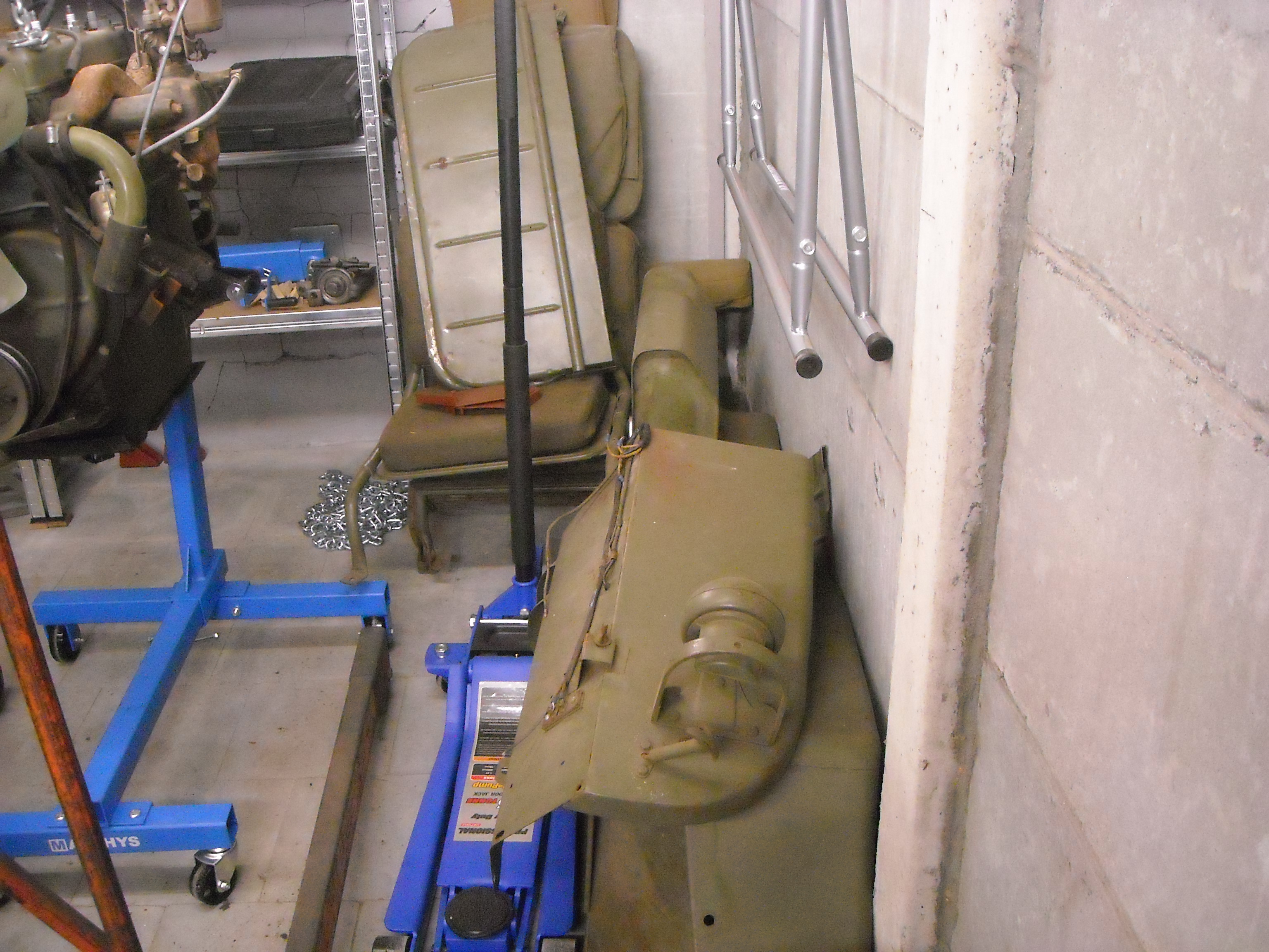

the fenders, seats,...
Fenders, seats, fuel tank,...

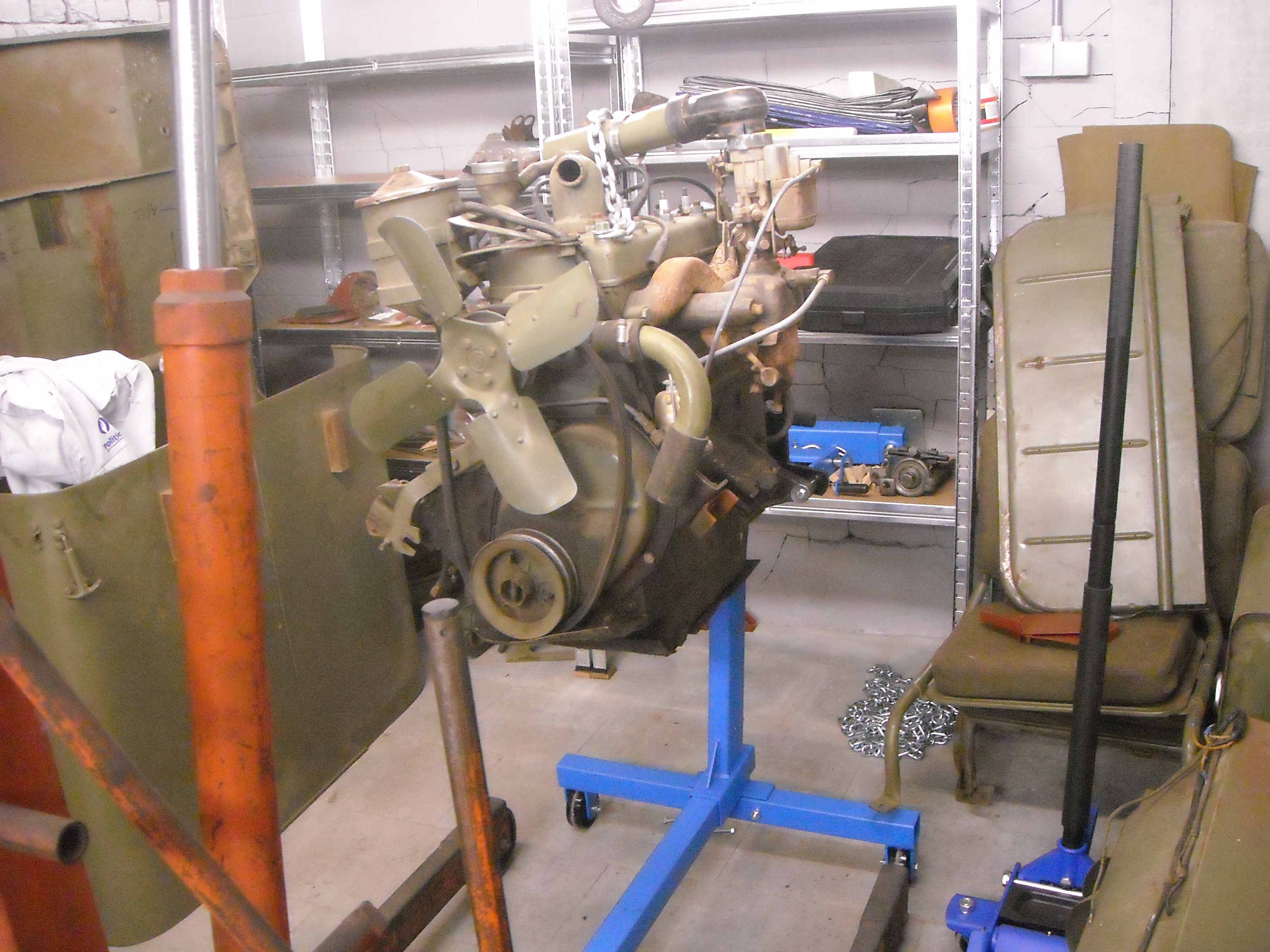

the engine
The GO DEVIL engine

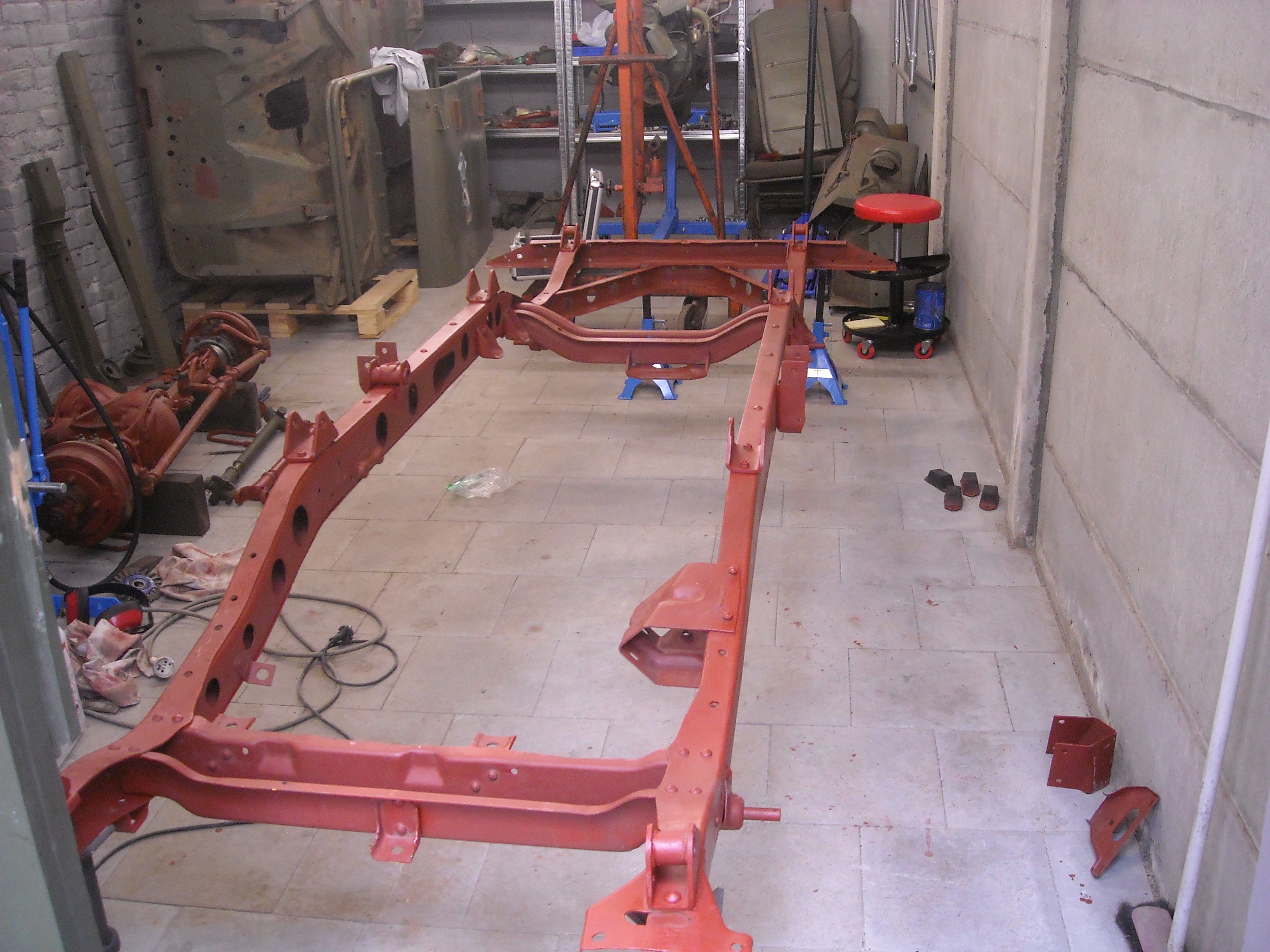

#7 PostAuthor: Philippe » Mon Oct 02, 2023 4:55 am
Hi men
a bit of progress the past week:

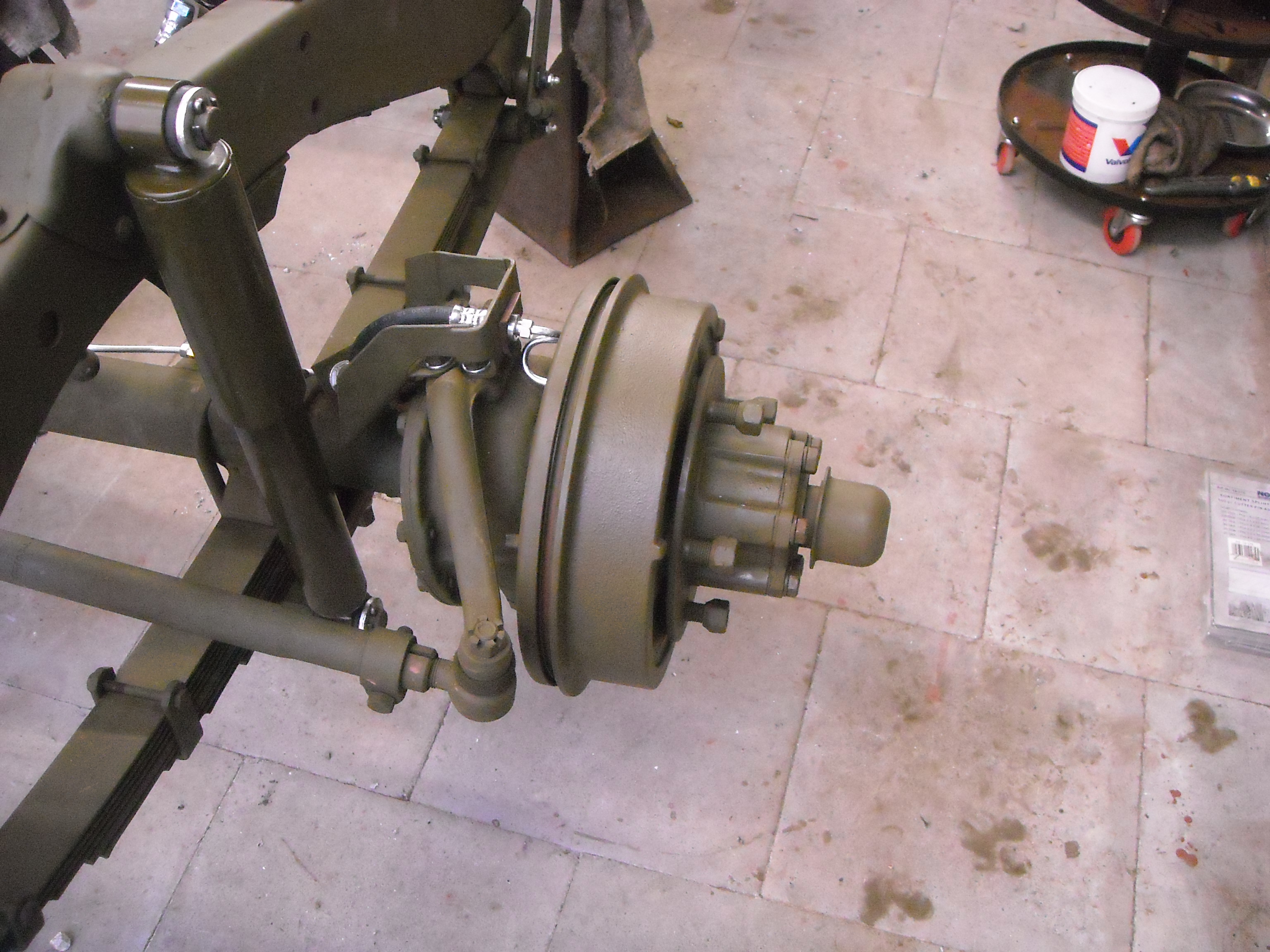

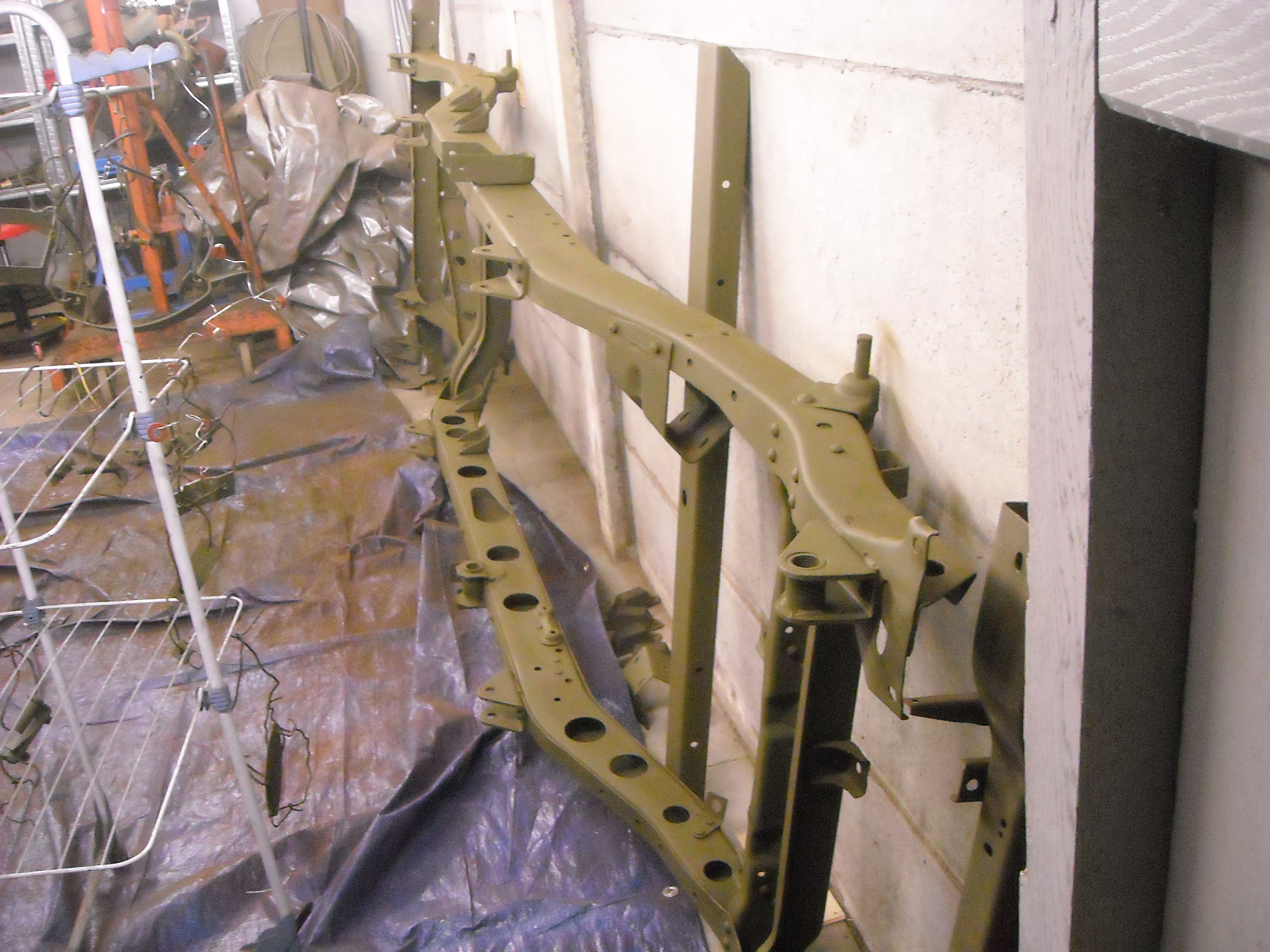

The frame is painted in olive drab, my wife helped me to turn it over several times in between the different coats of paint.

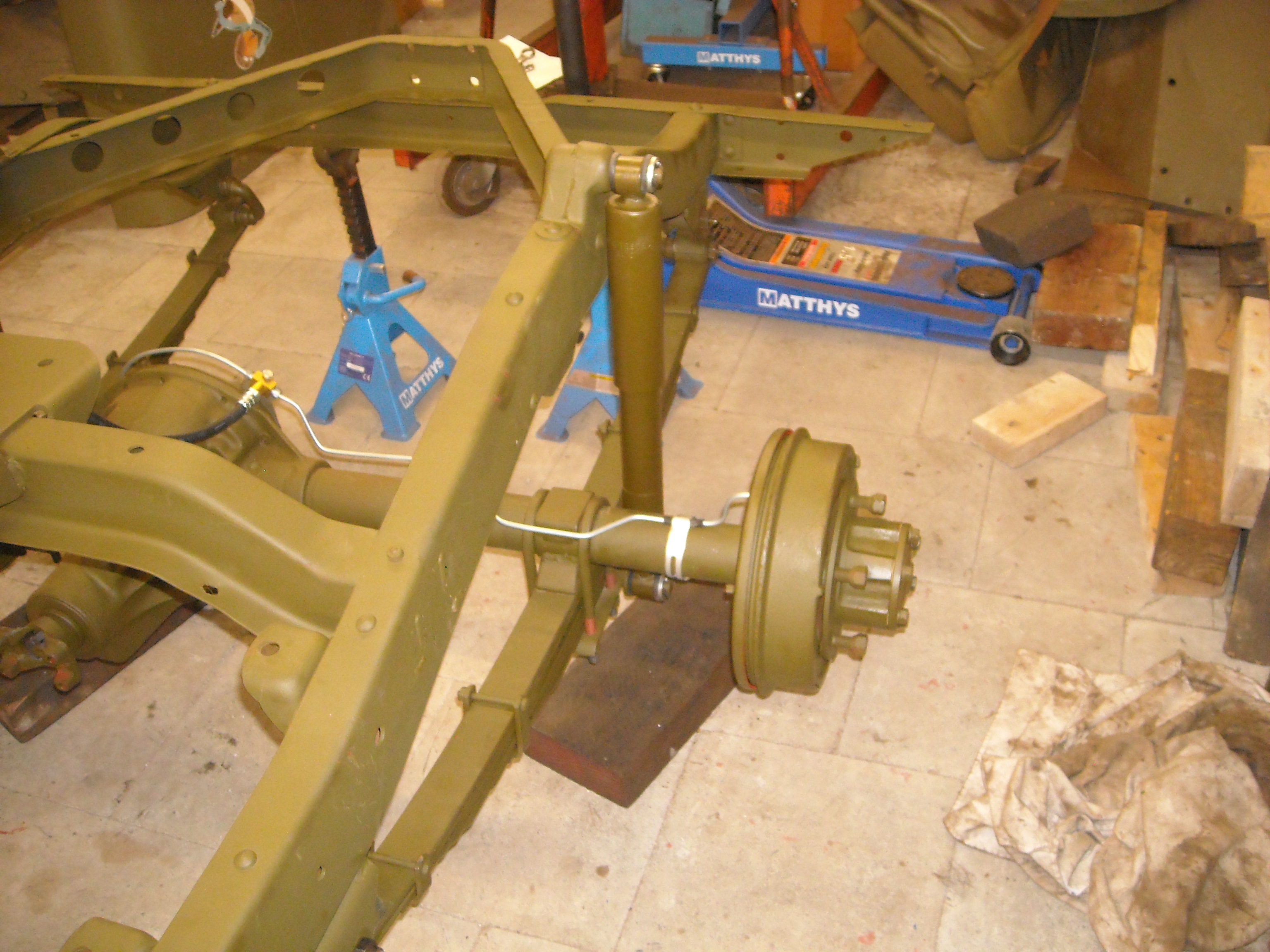

The front and the rear axle are opened, the bearings were OK, they look like new!
Unfortunately one of the brake drums is cracked, it will be replaced. Safety first!
These are allso painted in olive drab.

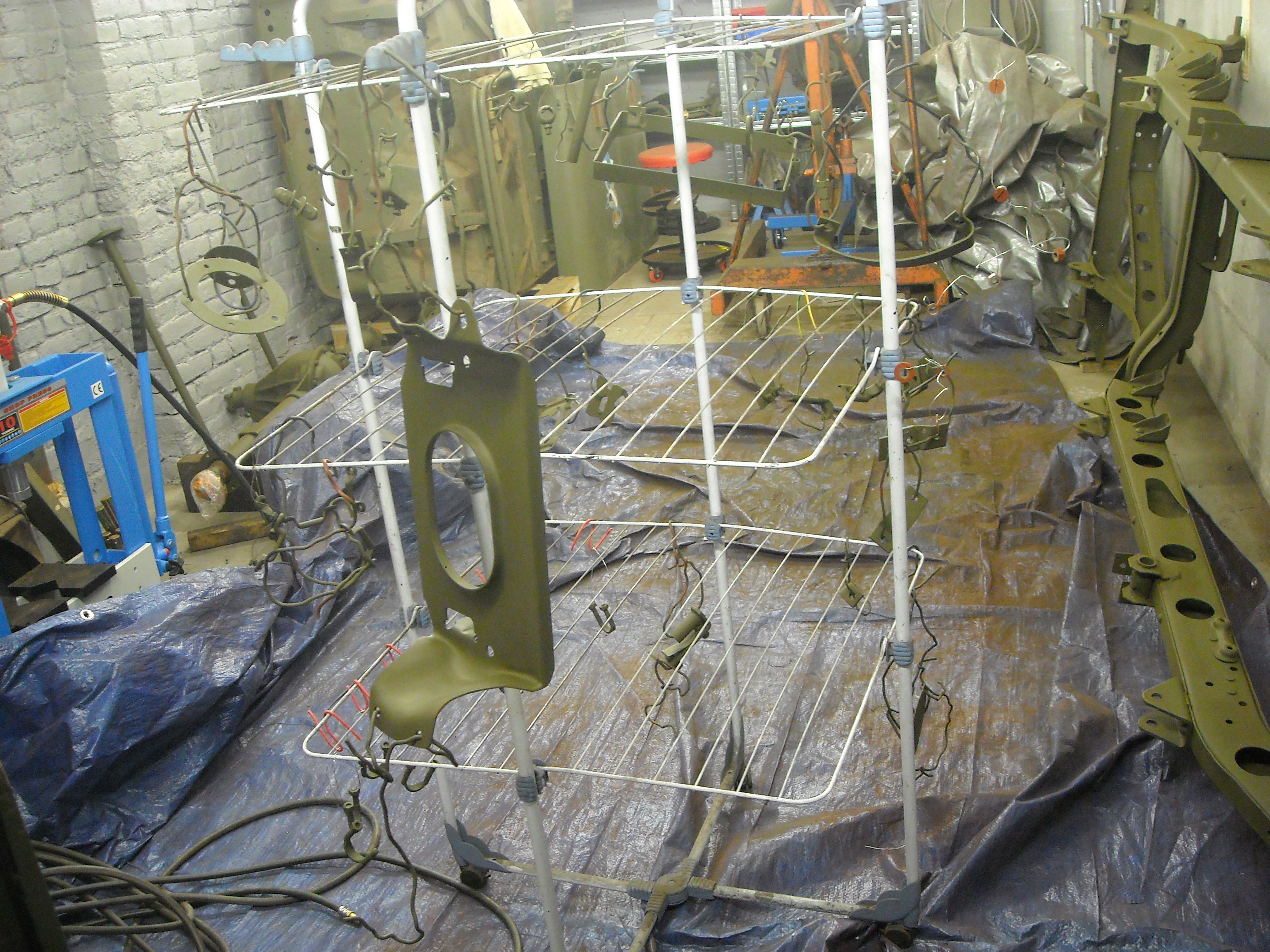

A lot of small parts are allso painted. I think some of you will recognize the way of storing them in order for the paint to dry...

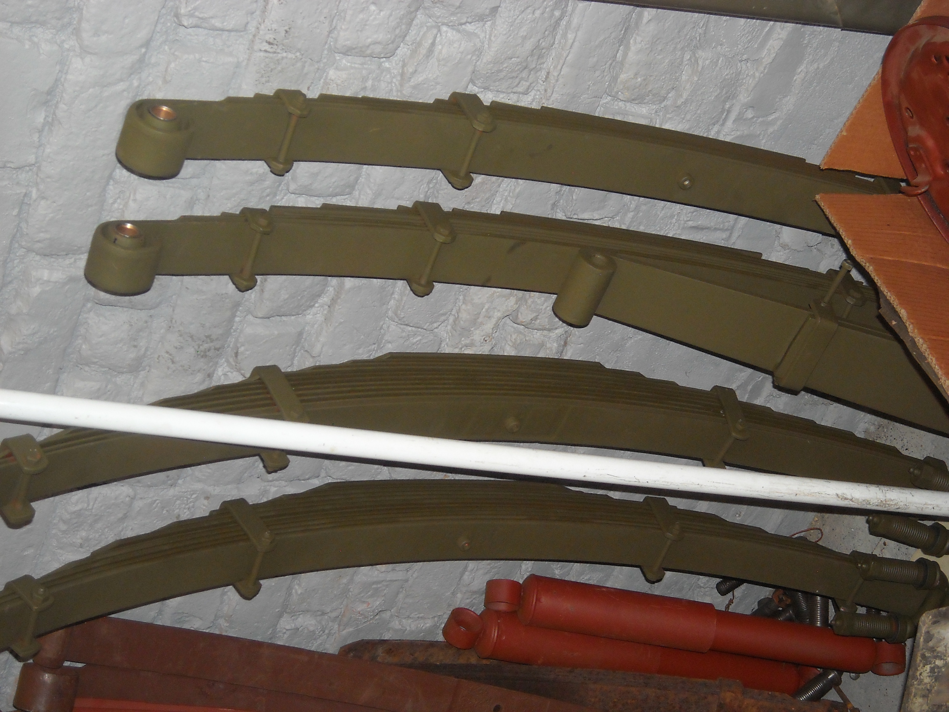

The leaf springs are ready to be mounted, once again painted in olive drab.
As a matter of fact all the parts (with a few exeptions) need a paintcoat of olive drab.
The engine must be painted in grey (Ford) .The radiator, the air filter and oil filter box need a coat of black paint.
That's all for today. More news next week.

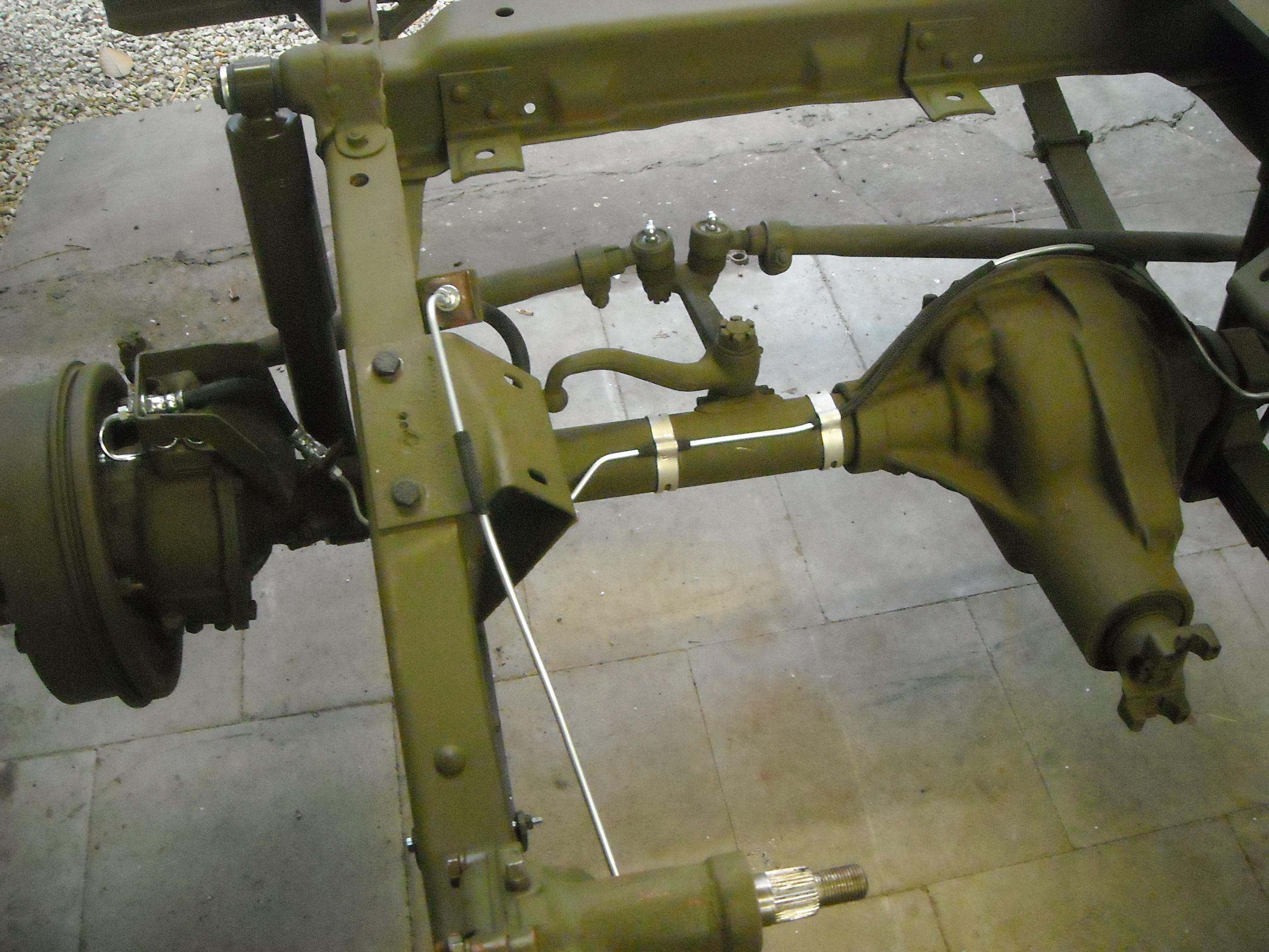

#15 PostAuthor: Philippe » Wed Nov 01, 2023 2:24 pm
Hello men
It's been a month since my last post, sorry for that...
But I've been busy the last month:
- a lot of parts received a red oxide primer and a coat of olive drab.
- I was able to buy a lot of parts (starter engine, dynamo, good brake drums and wheel hubs, a lot of smaller parts,...)
- the jeep is getting shape

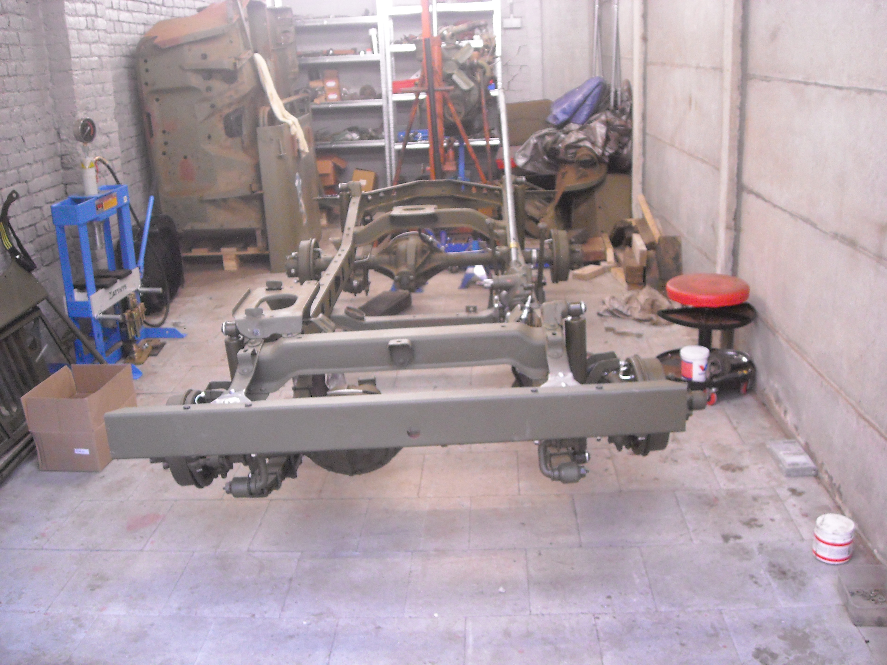

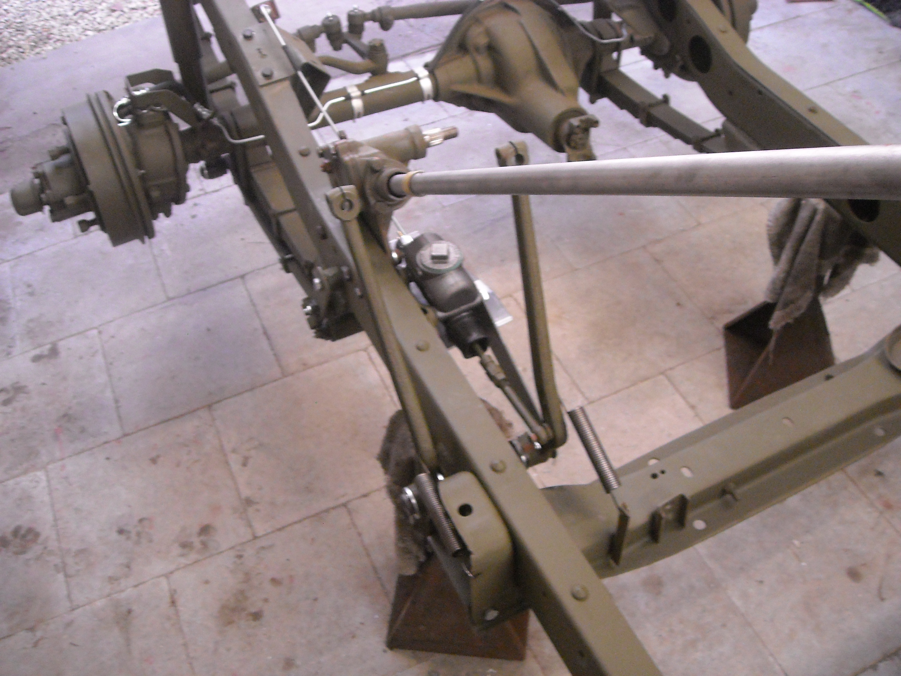

The axles, springs, pedal levers are mounted on the chassis.
The master brake cylinder and the steering box are mounted

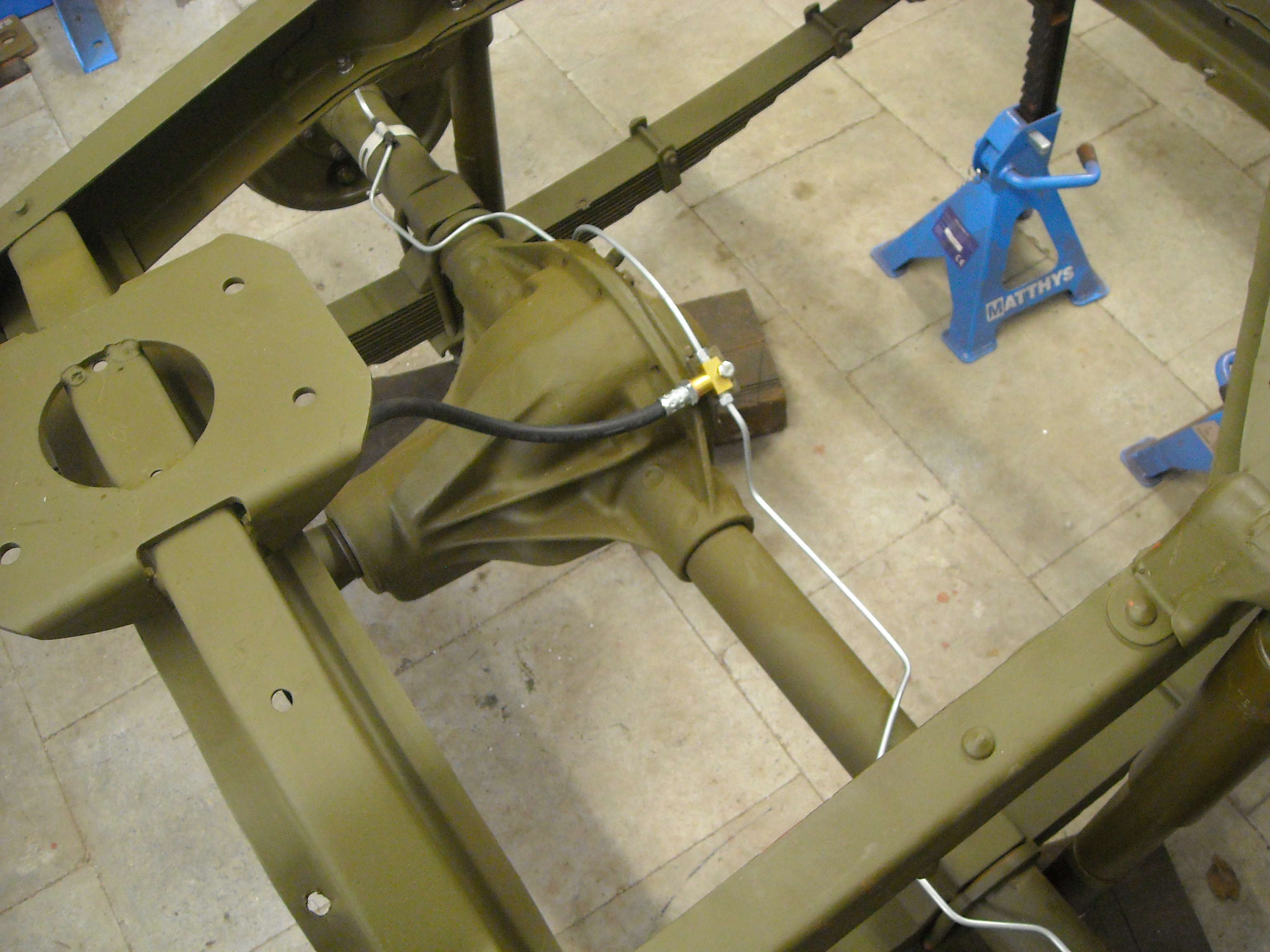

New brake lines at the rear and...
at the front of the vehicle.
New shock absorbers at the rear and at the front.

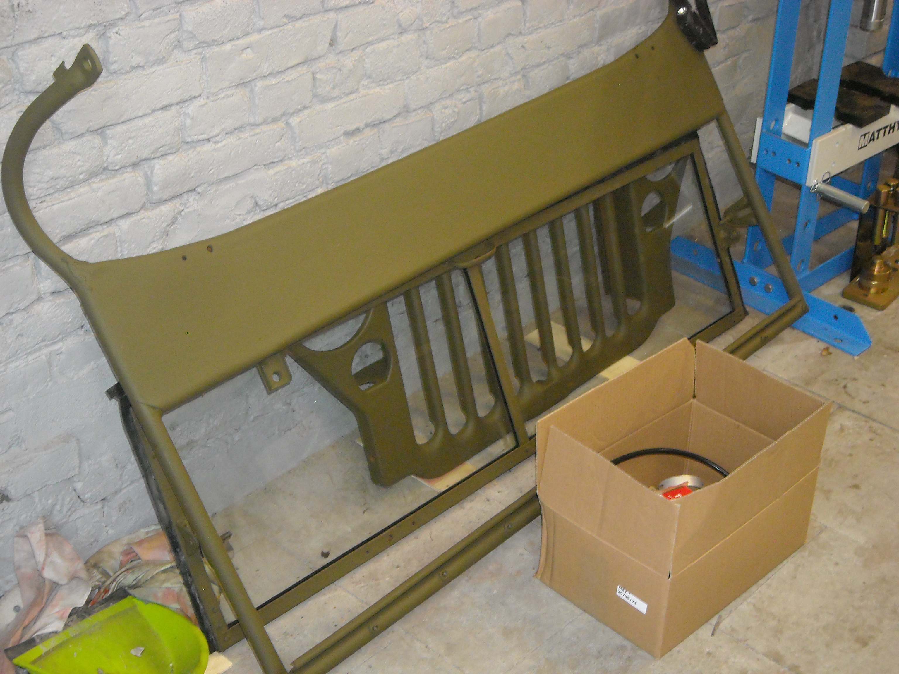

The radiator grille and the windshield are sprayed, the windshield received new safety glass

When those are mounted I'll have a rolling chassis.
The next step is to tackle the engine, taking it apart, checking the parts, replacing if neccessary and painting .
