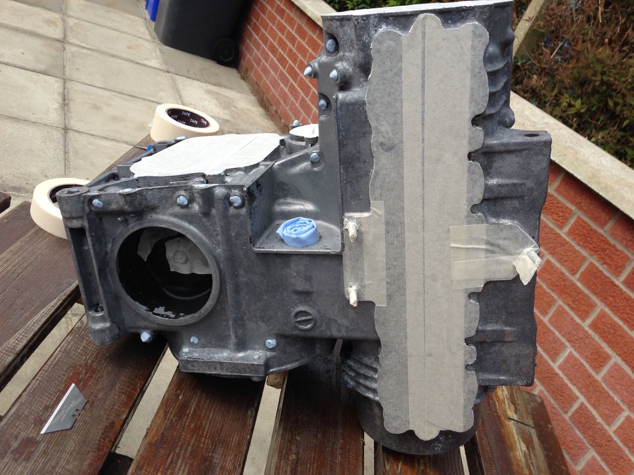

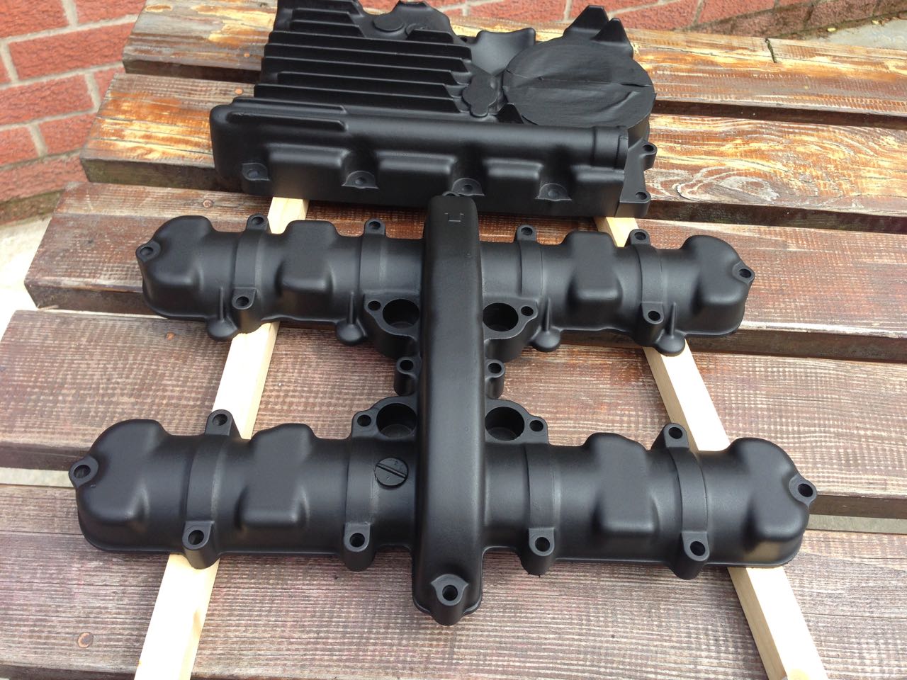

#34 PostAuthor: Kwackman » Fri Jun 02, 2017 4:43 pm
I've never resprayed an engine before, but if the black paint sticks to the engine casings like it did to my finger nails I'll be happy! Blue-tac is an attempt to protect threads and oil ways. Fingers crossed!

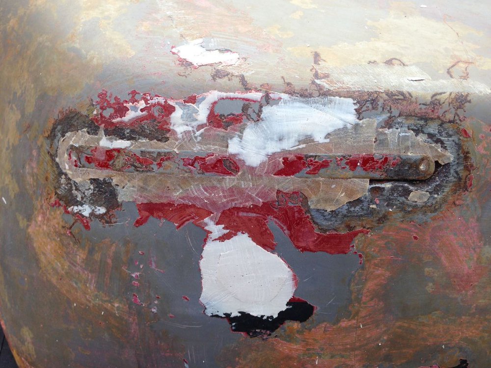

Tank prep

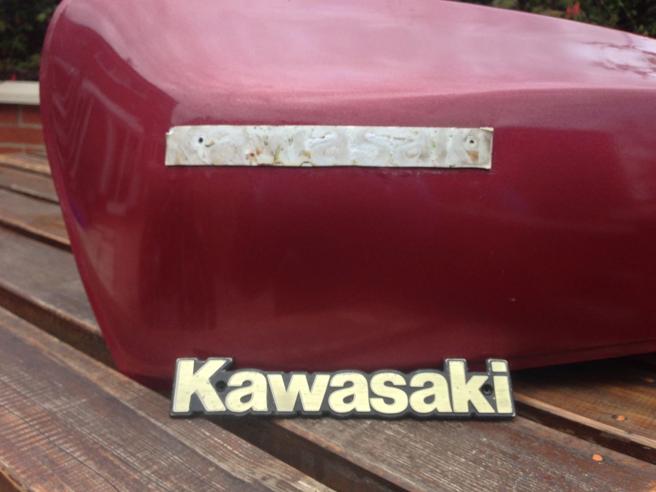

#35 PostAuthor: Kwackman » Fri Jun 02, 2017 5:02 pm
I wondered why the "Kawasaki" badge was stuck on, rather than screwed on...
Tank as I got it

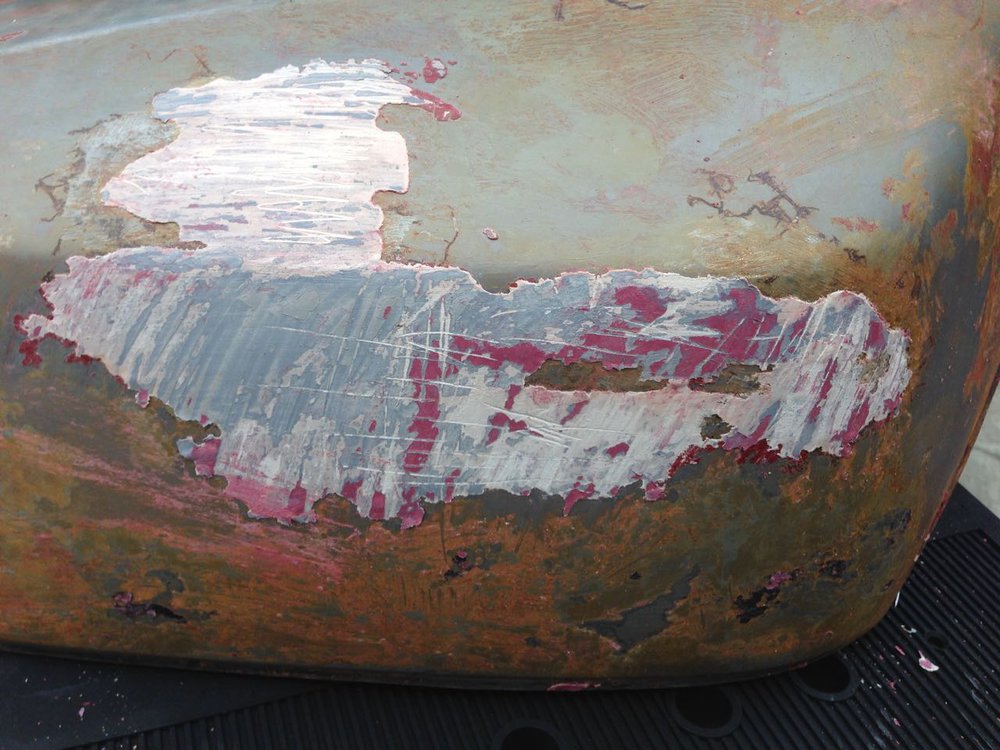

Paint stripper - forget Nitromors, it was useless. This was Synstrip's work. It's like the older Nitromors. Luckily I found one local shop that sold it.
Synstrip

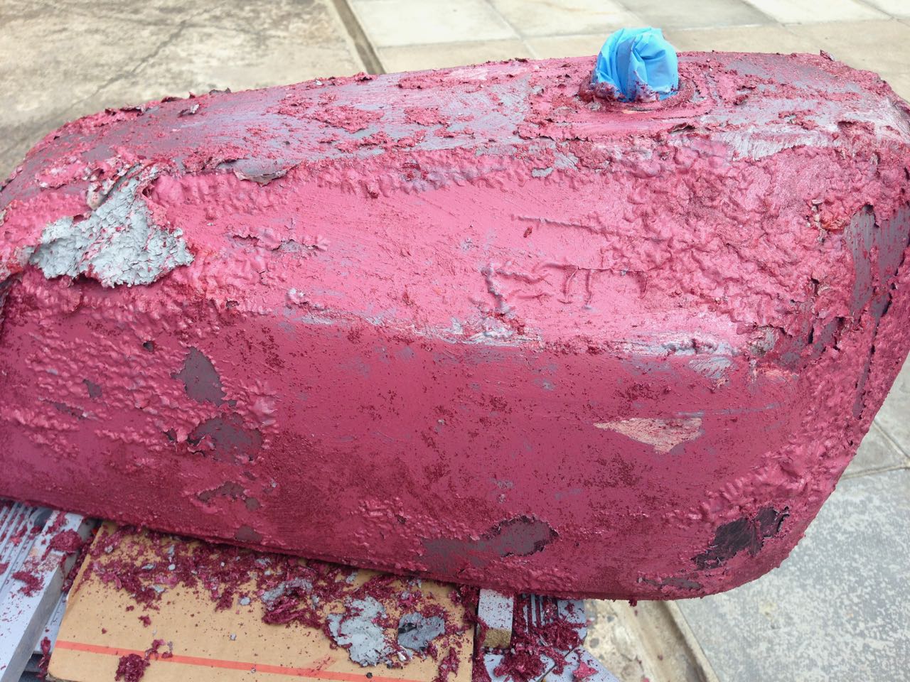

Even Synstrip won't take off layers of (I think) filler, and some resin substance. Scraping off slowly using stanly knife blades.
Scraping 1
Down to this point now, at least I can see where the screws are supposed to go!
Scraping 2
